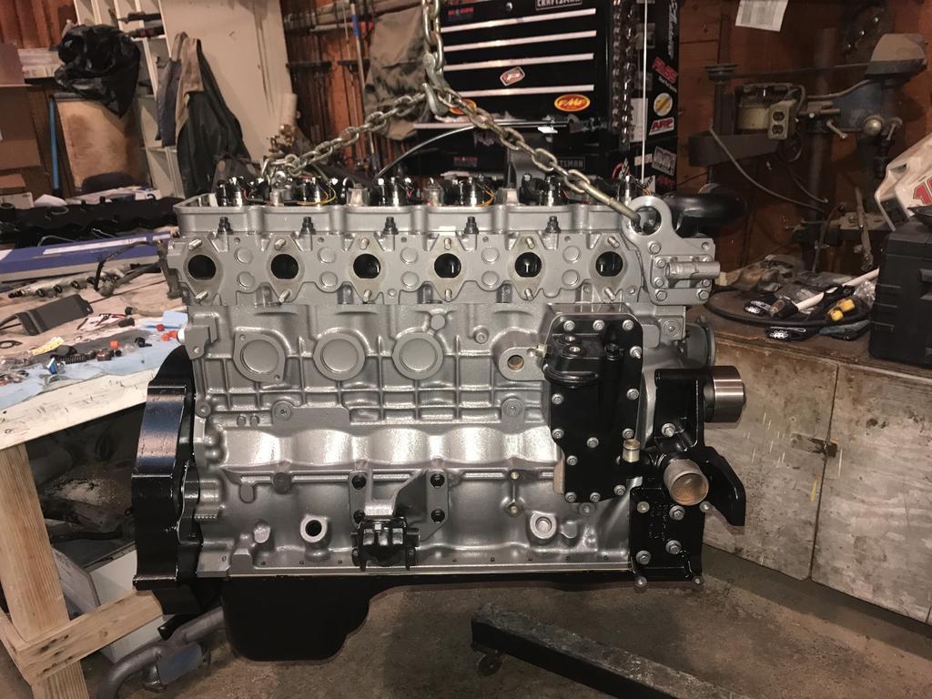

Photos before I put all the old "ugly" looking stuff on.

Well my initial intention was to sell this vehicle when I finished, that went out the window I ended up spending waaay more than I thought. I'd like to say before I begin my part list a whole bunch of this was not absolutely necessary.

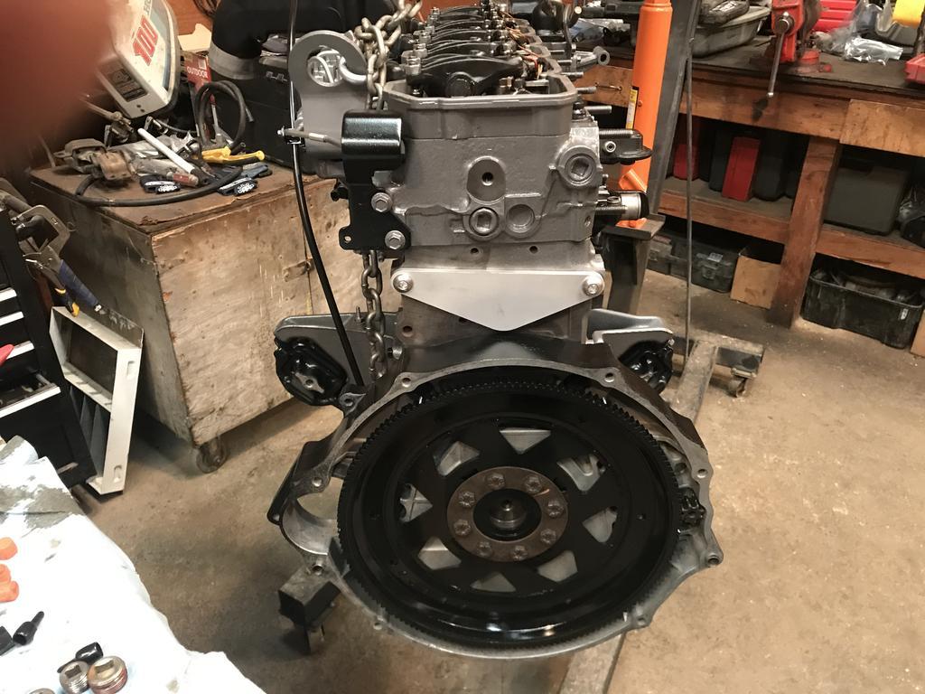

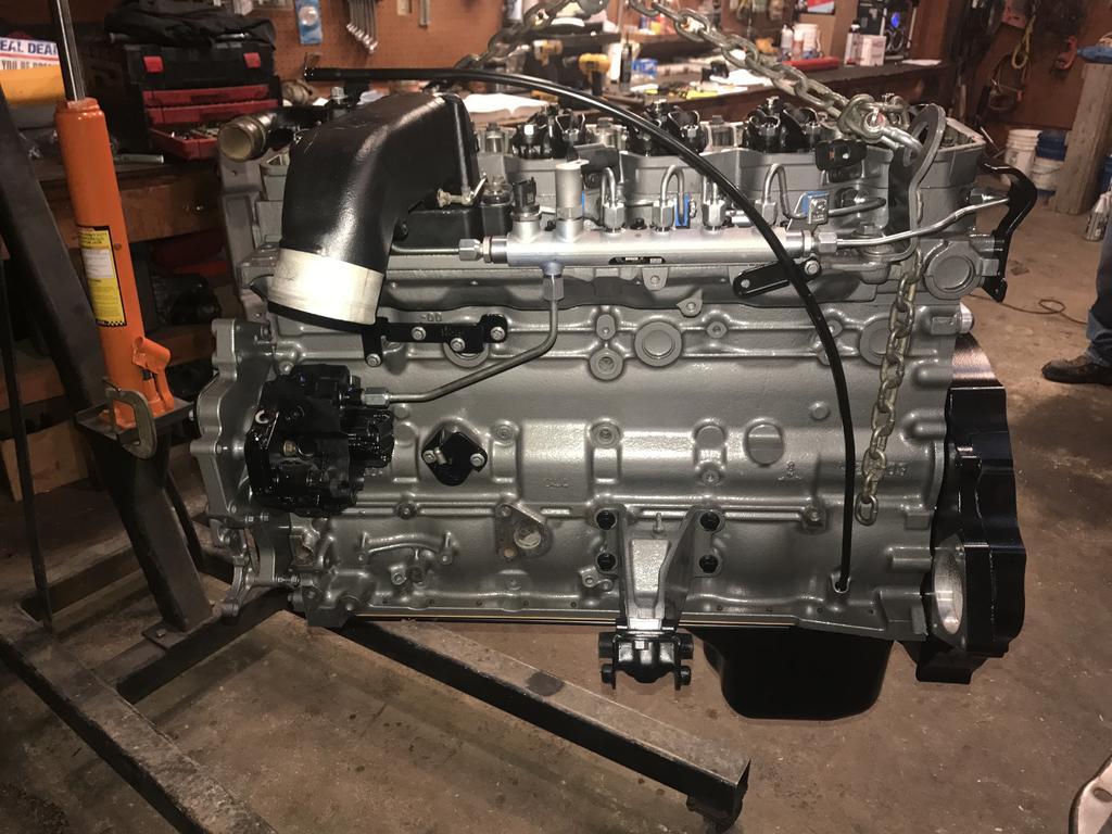

Machine shop: $3,900
includes
Motor was bored 0.5mm (0.020"), full engine rebuild kit Mahle, cam an lifters ground, replacement head, new valve springs, crankshaft an connecting rod inspection.

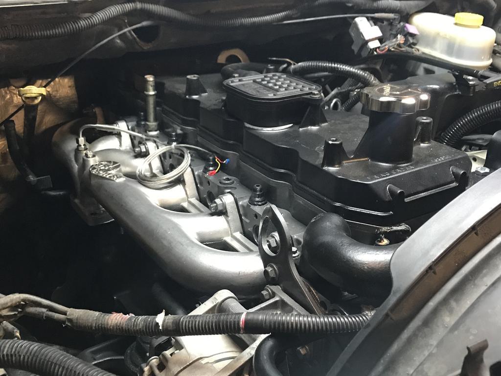

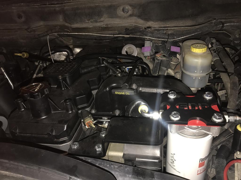

After I got that done I didn't like the way my camshaft turned out, ended up going with a colt cam stage 3($600), new lifters ($170), BBI reman stage 1 injectors ($2,400), heavy duty laminated flex plate ($275), MADS smarty touch ($850), ARP head stud kit ($450), AFE stainless steel exhaust manifold ($610), fluidampr ($435), MBRP exhaust system ($445), fuel rail with sensor an relief valve ($360), 6 injection lines rail to head ($30 each), crossover tubes ($300), cp3 reman ($700), fass fuel pump ($600), water pump ($160), engine oil cooler ($80), GDP additional 2 micron fuel filter ($260)

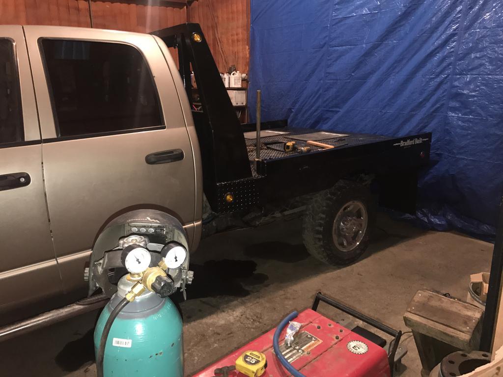

Think I covered most of the stuff I did to the motor but I've turned this into a full rebuild of the entire vehicle including dynatrac ball joints, synergy steering upgrade ect. Bradford built flatbed just got on yesterday. I've drove out my driveway a couple times runs AWESOME just a few more little things morning an I should be able to drive it to lunch finally lol, hauled it home November 15.

Bromiley99,

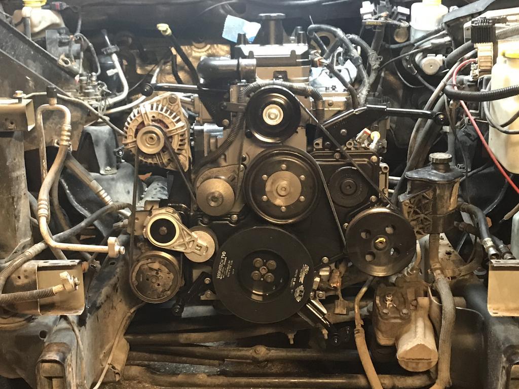

I hope you don't mind my stealing a few of the frontal engine pictures for another thread.....your pictures show the alternate set of holes for the non-A/C tensioner set-up that's been like hunting for the holy grail...
Mike.
Bromiley99,
Mike.
Go right ahead sir!!
