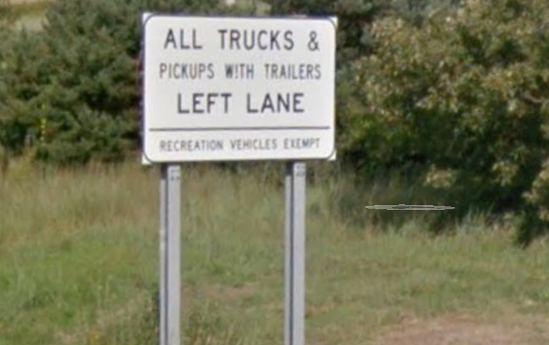

The OP is pulling a horse trailer. The LEO in the scale house has no way of knowing that it is registered as an RV. If it was me, I would roll across the scale knowing that there is a 99.99% chance that I'll get a green light and be on my way. IMO, that is much better than being chased down by an LEO and the hassle of being pulled over. Since you are there anyway, it might be a good opportunity for a vehicle equipment check, you know, lights, horn, tires, etc.
This is the sign approaching each direction at the scales in Nebraska City and North Platte, Nebraska. I have seen pickups with trailers pulled over just past the scale. Other times, they fly on by. I always stop with my private pickup and trailer and have always gotten a green light.
