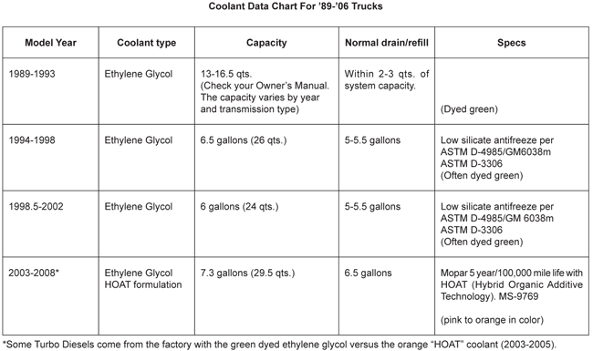

Q5: In issue 54 TDR writer Andy Redmond gave us the specifications for coolant. Could you do a reprint?
A5: You bet. Here is the TDR Issue 54, page 157, reprint:
Coolanta Data Chart - '89-'06 Dodge Turbo Diesel Trucks

Q8: Okay, the Chrysler’s recommendation up to year 2002 says ethylene glycol. Isn’t that the traditional “green stuff” that has been around for years?
A8: Yes, just be sure to use a low-silicate antifreeze per ASTM D-4985/GM6038M and ASTM D-3306.

Q10: So I understand that the green stuff (an ethylene glycol, EG, IAT, silicate formula) antifreezes need more frequent servicing as they plate-out as they provide a protective barrier to corrosion. How about Chrysler’s recommendation for the ’03-’08 cooling systems of a hybrid organic additive technology (HOAT) that is good for 5years/100,000 miles? What is HOAT?

As a bridge between OAT and IAT there are the hybrid coolants (HOAT) that use both silicate and organic acid corrosion inhibitors. HOAT type coolants are the factory fill for many OEM vehicles.2 Your ’03-’08 Turbo Diesel uses HOAT.

Q13: What coolant should I use?
A13: Looks like we’ve done a complete 360° walk around the block (cylinder block, that is). Please see the reprinted table that Andy Redmond provided in Issue 54. The short answer: Chrysler specification MSS-9769, HOAT coolant which is backward compatible to all years of the Turbo Diesel. That’s right, use the yellow stuff after you drain the green stuff. And, thankfully we do not have to be concerned with cavitation erosion.
