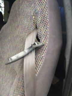

Damn seat belt retainer (or whatever the piece that BRILLIANTLY guides it through the seat is called) has broken loose and is an incredible PITA everytime you go to buckle up. I can't see a way to fix it short of finding another seatback w/ belt attached. Tell me there's some simple fix I'm overlooking because otherwise, there's a Dodge engineer I'm wanting to punch in the face.
That sounds pretty annoying Bunchgrass. 2nd Gen parts are becoming harder to find. The wrecking yards around here say whenever they get a 2nd Gen Ram in the parts go fast, they are in high demand. You might find a wrecking yard through car-parts.com that may have what you need.
Thanks! I'm not even sure what sequence they used to assemble this thing. I was looking at a few 2nd gen rigs on some junkyard sites near me and saw a pretty nice tailgate and even an 8' bed. Called. The guy says those parts are already spoken for before they ever arrive on site. Oh brother.
I'm guessing the backrest cover needs to come off to re-snap the inside piece to the one that's visible on the outside. Not sure if there's a zipper at the bottom of the seat back or possibly velcro. Tilt setback all the way forward and take a look. You might have to remove bolts that hold setback base to bum (where your butt goes) to access.
Won't look pretty but you could cut the blasted thing off. Think I'd take the more subtle approach, at least at first...
Yeah --- It looks like that plastic trim piece has pronged feet that grab onto something when you pop it back in place. At least one of them appears to have broken off. Youtube has some good videos of people taking the seatbelts apart as they seem to get jammed up in these Gen2s. There's some weird solenoid thing up in the seatback that supposedly locked the belts if the wheels began to slip (that's the story). Solenoid goes bad and your seatbelt won't pull out. Anyway -- showed how to get it apart except not much on popping that plastic thing off. Wonder if I get the plastic piece if I buy the seat belt from the scrap yard.
Can you feel or see a “frame” that it would snap into? It’s possible there’s just a similar piece on the other side of the cover that it snaps into that retains the cover between them to hold it in place.

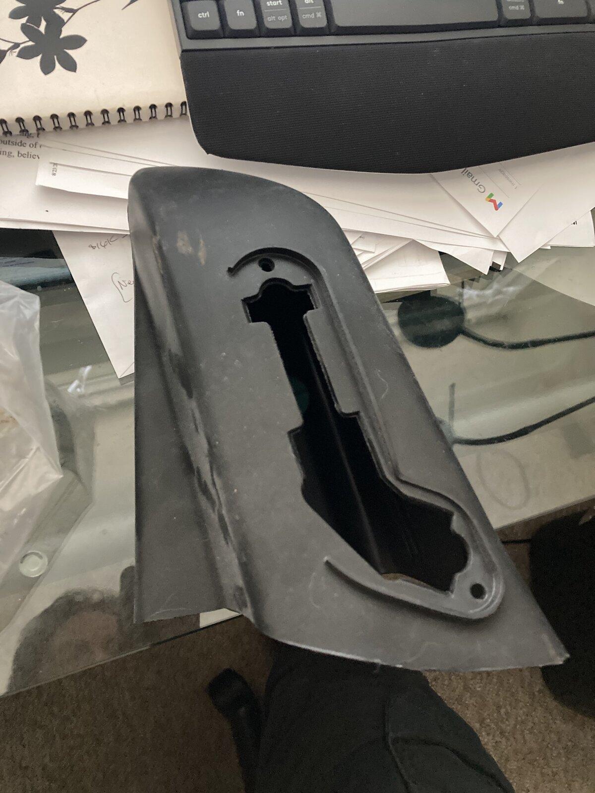

I just pre drilled that plastic guide on each side of the face flange and drove 2 small panhead screws 3/4" long into the face flange on right and left side into the plastic seat frame underneath the seat cover to hold it in place. Problem solved. You can pull the fabric back to see what your screwing into. I hate plastic cheap plastic crap like this that Dodge uses, like the dashboards that disentigrate. There should be a class action suit for that except its only the lawyers who get anything in the end there.

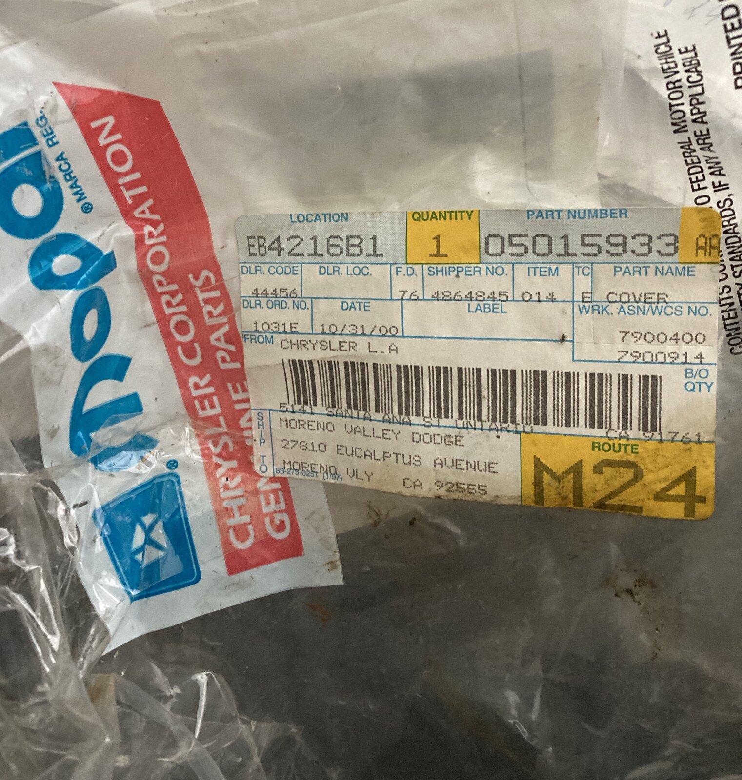

I had the same problem on both the front seats when i got my 99 tuck. This is what you need. The trim snaps into it. If yours is broken like mine was. If the tabs on the trim ring are ok. You can just pull the seat back cover off and replace this. It takes as little time to do this.
