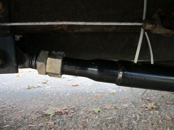

Thread is 1-1/8"-7. I couldn't come close to finding these locally, so I ordered them from McMaster Carr.

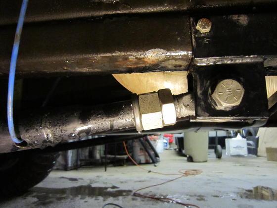

He feels ½ turn pre-load is too conservative. Said to put a jack under the bumper raise the truck up. Give the bars about 1 revolution pre-load & tighten the nuts up. <!-- google_ad_section_end --> <!-- / message --><!-- sig -->
How can raising the rear bumper simulate a load in the bed?
Or am I missing something?<!-- google_ad_section_end --> <!-- / message --><!-- sig -->
Lifting the truck a little takes some of the strain off of the suspension. When you preload the bars, you are actually pressing the rear axle back slightly... such that when your truck is loaded heavy, the bars actually go into compression somewhat.
If you snug the bars up with the truck on the ground, the bars should be slightly loose when you jack the rear bumper up. Thus, jacking up the truck first, and then preloading lets you get a little better preload.
--Eric

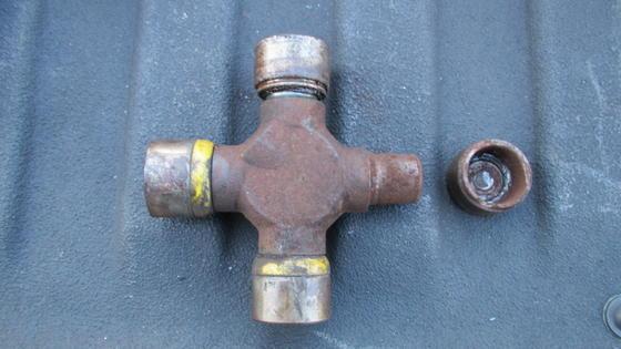

Would Lazer/Smith T-Bars be Tough on U-Joints? This one is a lubed for life. It lasted 2 years. My OEM lasted 215,000 miles. This is the far rear one that attaches to the rear end.
Looking at the picture he provided, there has been no grease in that joint for a while. Factory universals always seem to last much longer than aftermarkets, I agree on that. Ive just never had any luck with sealed aftermarket universals. If that one had been serviceable, and he would have been able to throw a couple of shots of grease in it every other oil change or so, I would be willing to bet it would have lasted much longer.
