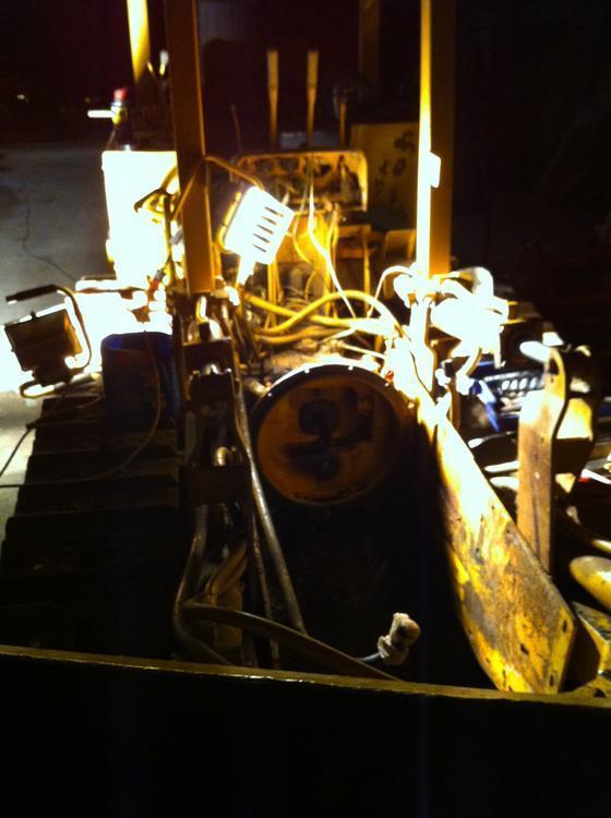

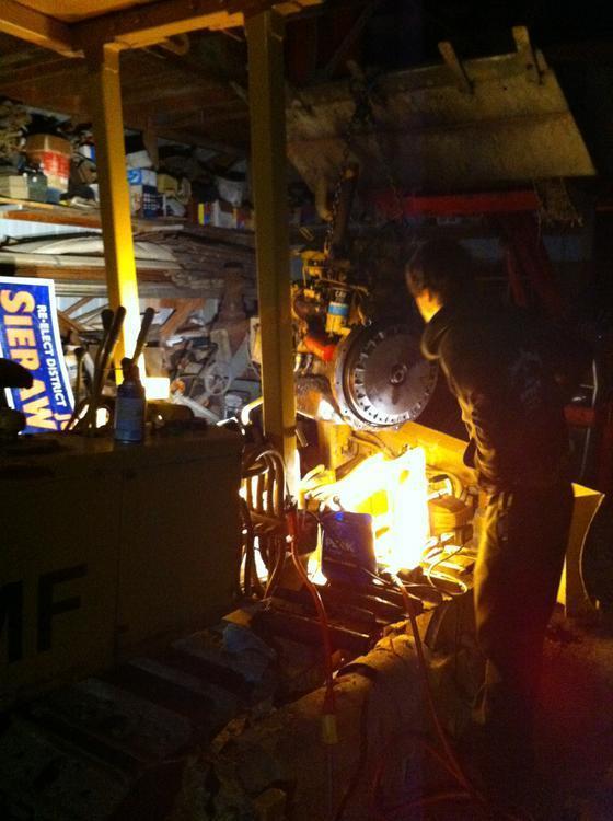

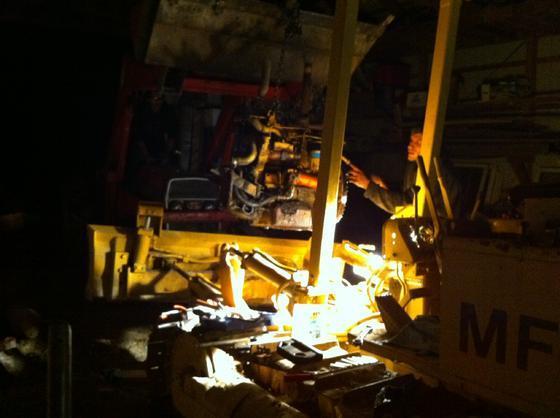

Here are a few pictures after we got this giant 3 cylinder perkins out. Please note my shop is a 80x40 barn with out electricity other than a really long extension cord and my engine hoist is a 245 Mf tractor so I felt pretty accomplished after the fact:D. Thanks for the different part sources. yesterdaystractor was kind of a let down. They had tons of stuff but mostly just generic parts, but is in a different league compared to my local MF dealer. They do have an owners manual that seems like a no brainer... The real question now is has anyone ever operate one of these machines?
