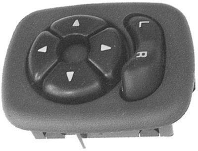

I think the mirror wiring will be fine, I am conserned about the control switch. Here is a picture of what the book calls for, for my year but my door panel is designed for the rotory knob style switch. They have a different wiring harness. I am not sure what I actually have for wiring behind the door panel. I guess I just need to order the mirrors and deal with the wire issue, if it even is an issue. Thanks again for your input.

Awesome, let me know how it goes. I just ordered a set of the cool vue for $229 per set and includes the heavy bracket's, free shipping but they taxed me:confused: I found several rotary switchs on ebay but no phone numbers so I had to pass. Ended up ordering one from O'Reileys, big $$ and will take about a week. I think the flat faced switch in the picture is for an '03 and up, parts books are wrong I think. The rotary is hard to find, new.

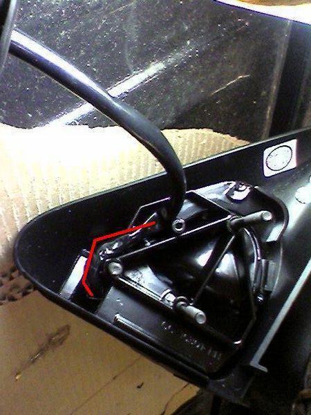

I installed mine a couple of years ago, back then they did not come with any install instructions, that may have changed. Be very careful how you run the cord on the backside of the mounting plate. If they are not in the right spot, the wires get pinched and cut when you tighten up the mirror base. Here is a pic of how to run the wires.....
Also, if you are using the factory switch, unless Koolvue made a change, one of the mount studs is too long and hits the back of the switch and the door panel won't go back on all the way. You can file off the end of the switch for clearance, which is what I did. I read others have cut/installed a shorter stud but seemed like a hassle to me. Before you start, roll the window down, it makes it much easier and you don't need to pull the door panel off all the way. Just take the screw out and pop the clips on the front, vertical edge, the panel will flex enough to tighten the nuts and connect the plugs.

Sam, thanks for the install tips and pictures. The partial door panel removal is great, I have the worst luck with panels and clips. At this time I am not going to get the heat style control unit.

Yep. AM Autoparts is the best I've used, so far. The round switches are the ones for 95+, but the 98. 5+ is different than the earlier trucks, and you have to order the mirrors for 98. 5+. The wire loom is in the truck, it's all just plug and play. I just did a 2001 in March, the switch came from the bone yard.....
Did you order BWD S13505 from Orielly's? If so, I believe that's the one for the 97 and earlier, and won't plug into your wireloom. Please correct me if I'm wrong... . but I ordered one of those last summer for one that the mirror rubbed into and shorted out, as mentioned above as the top bolt was too long. The switch didn't fit the '98+ wireloom... . :cool: The later models are a thinner, flatter connector than the earlier models.....
Yep. AM Autoparts is the best I've used, so far. The round switches are the ones for 95+, but the 98. 5+ is different than the earlier trucks, The switch didn't fit the '98+ wireloom... . :cool: The later models are a thinner, flatter connector than the earlier models.....
Yes, you are so right:confused: I just found that out yesterday. The older switch has an 8 prong plug, my truck uses a 10 prong with 8 wires, jeeze! I did find one on ebay with a seller that lists his phone number so I will call and order it as soon as they open.
