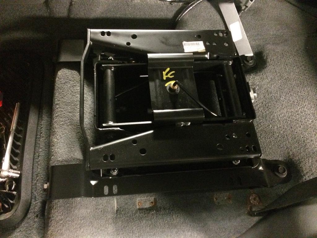

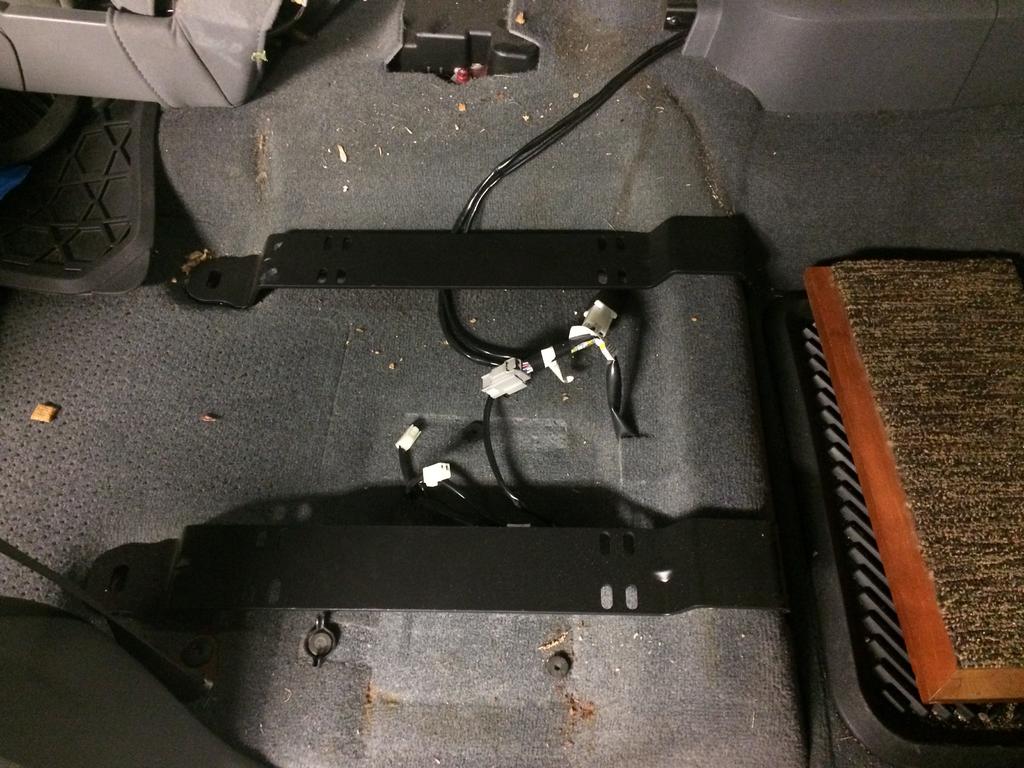

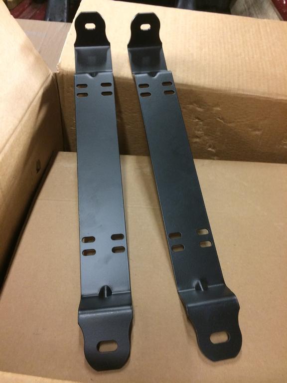

I owe you some pictures. Going to do a new seat install thread but here are a few showing how the adapter plates are made..
First two pictures are the passenger side, last is driver side.

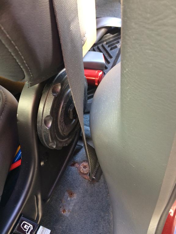

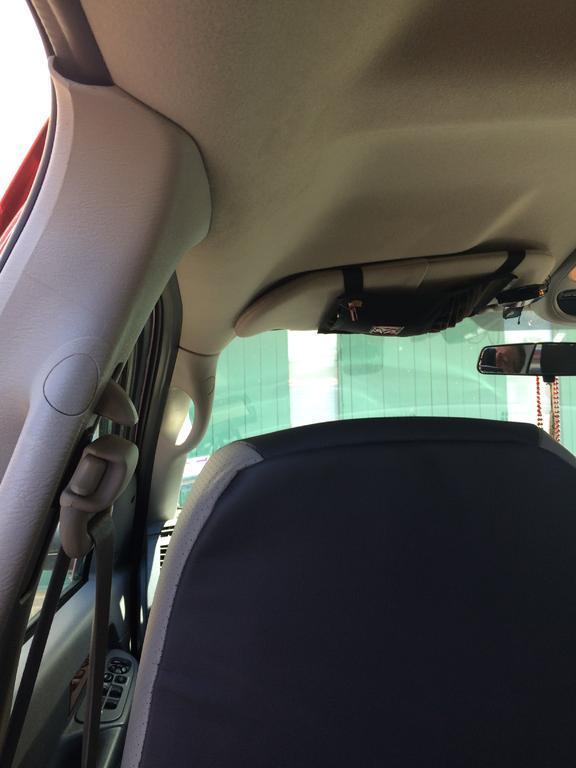

This is kind of a sneak preview as my install is not completed yet... but two areas to watch if you go with the Knoedler seat are the seat belt retractor bulges and the taper of the cab. Seats will have to have the same width and taper or there will be clearance issues.
Seat is fully down so when raised 4" it is going to be close to the pillar...I'll get a picture when I get the air connected..
