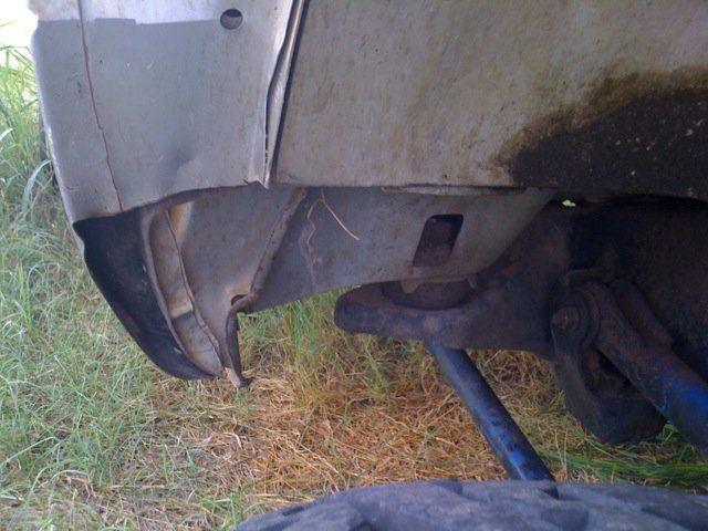

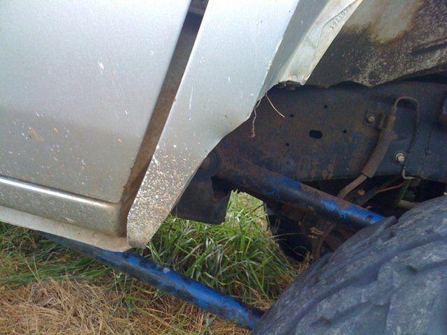

Just pull the whole plastic fender liner out. Looks cleaner than cutting the plastic, IMO. Then you can go to cutting the fenders... ... And that will only fit about a 37 until you go to a 6"+ lift. When cutting the fender, you can clear the 37s, depending on wheel, by cutting the fender and just a small part of the cab where the spot welding is.

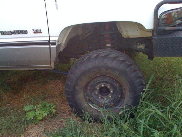

Here's a pic a truck I built a few back. The fenderwells are painted under the liner from the factory... ...
Not sure why they're upside down..... WTH? They weren't like that when I uploaded them... .
Anyway, you can cut the fender, and only cut the lower part of the seam where the cab is welded together, so it won't break apart from flex. The fender is not attached at the lower point anymore, but it clears 38x11. 00x16 Boggers until you compress the bumpstops and turn too far, using factory steel wheels.
Then, we "modified" the fender with a body working tool, about 3 lb works good, and fold the seam over to keep it from cutting the tire during compression.
Thanks for the pics, gives me an idea of what is under the plastic. My locking hub set up is a contributor to the rub (my favorite addition to the truck). They push the front track width out to 1. 5"-2" wider.
I think the only issue I have is the seam. This is the only location I am seeing the rubbing, but I will need to remove the plastic inner fender to be certain. Maybe I can bend the seam over, flatten it out and add rattle can undercoating into the metal inner fender.

Yeah, but it reduces the overall weight of the truck by close to 1,000 lbs... . :D Add that and the Boggers it used to have on it, and the fact I only had $2400 in it, mostly in tires, and it makes for a nice budget wheelin' truck. I don't own it anymore, it's just sitting here for a place for it sit. Not exactly a fuel efficient daily driver... . :cool: Oh, and that fender is the only one that has any badging left, so it's closer in average to a 3/4 ton than a 5/8 ton... .
The next issue after cutting the fender is speeding up the rust process. That may or may not bother you
Rust isn't an issue in this area, but in some it would be, and in that instance, I'd suggest some galvanizing or rust convertor type primer inside the fender where it's been cut. Those haven't even been painted in the last 7 years, but there is very little rust, despite the weekly mud runs it used to get!!
As far as a lift goes, I think the lower the better, and the bigger tire the better. That's confusing to some, but I like my center of gravity as low as possible to stay right side up. The differentials are your biggest drag, so the bigger tire, the more clearance you have. I've used adjustable track bars, either ones I've made or aftermarket. The ones in those pics are of a Fab-Tech 6" lift I got off a wrecked truck for scrap iron price in a bone yard. The upper arms are attached on the rear to the frame where the lower arms used to attach, and the lower arms are anchored to a bolt on mount that bolts through the transmission crossmember back there. IT's a decent lift, and definitely worth the $150 I gave for it. There were taller coils and shocks, too, with complete leaf springs in the rear. Did I mention the RockRam AGR steering box and hydraulic cylinder that I got with it? :D Don't hate me... . :p But back to the adjustable track bars. 1/2 inch may be the max you gain with the longer arms. When the axle bottoms out, it will hit the tracking bar on the diff cover, breaking or bending it... . or breaking the track bar anchor off the frame. It has to be moved forward, and then you can gain around an inch with the adjustable arms, then you lose room for the steering rods, depending on if you have the upgraded crossbar or the smaller Y setup..... When you remove the fender liner, you gain probably 1/2 to 3/4 inch between it and the fender seam/cab bolt. Sitting at stock height, 35s are about all the tire you can get, maybe a little bigger. Add 2" and you can squeeze in a 37, depending on your wheel. Move that axle forward a little and trim the fender... . :D
