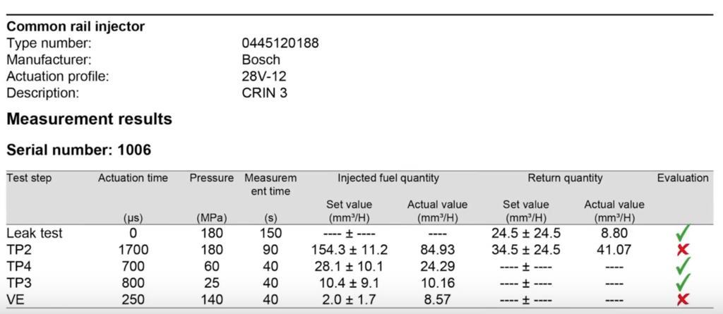

I'm installing secondary fuel filter ( Vulcan ) and in so doing am going to replace my original 150k injectors. Between assorted performance hiccups and the general sentiment that they need replacing, I'm confident enough to order replacement injectors. This will get me back on the road more quickly compared to having originals rebuilt, but also allow me to have these injectors bench-tested by a place that I found today after I called Bosch. This test shop has a Bosch EPS 205 and charges $40/injector. I'm surprised that I can't find result of a single Cummins injector bench-test posted on the Internet. Do most people not bother with spending money on the test or do their tests not generate a report that is printable and shareable ? I found a video on Youtube of EPS 205 that generates the below included report. Can anybody comment on the results, I don't know how to intepret. I'll post my results when I receive.

For the most part, the testing is so inconsistent and inconclusive it is not worth the $$ or effort. Test bench can not emulate in-engine performance, heat cycles play a huge part in observed performance, and the interpretation of the results is not objective. It is not unusual to see test results from different places contradict each other, or, multiple tests conclude the injectors are good when they show obvious signs of problems in a running engine. The results are so varied it is impossible to predict a valid result.
