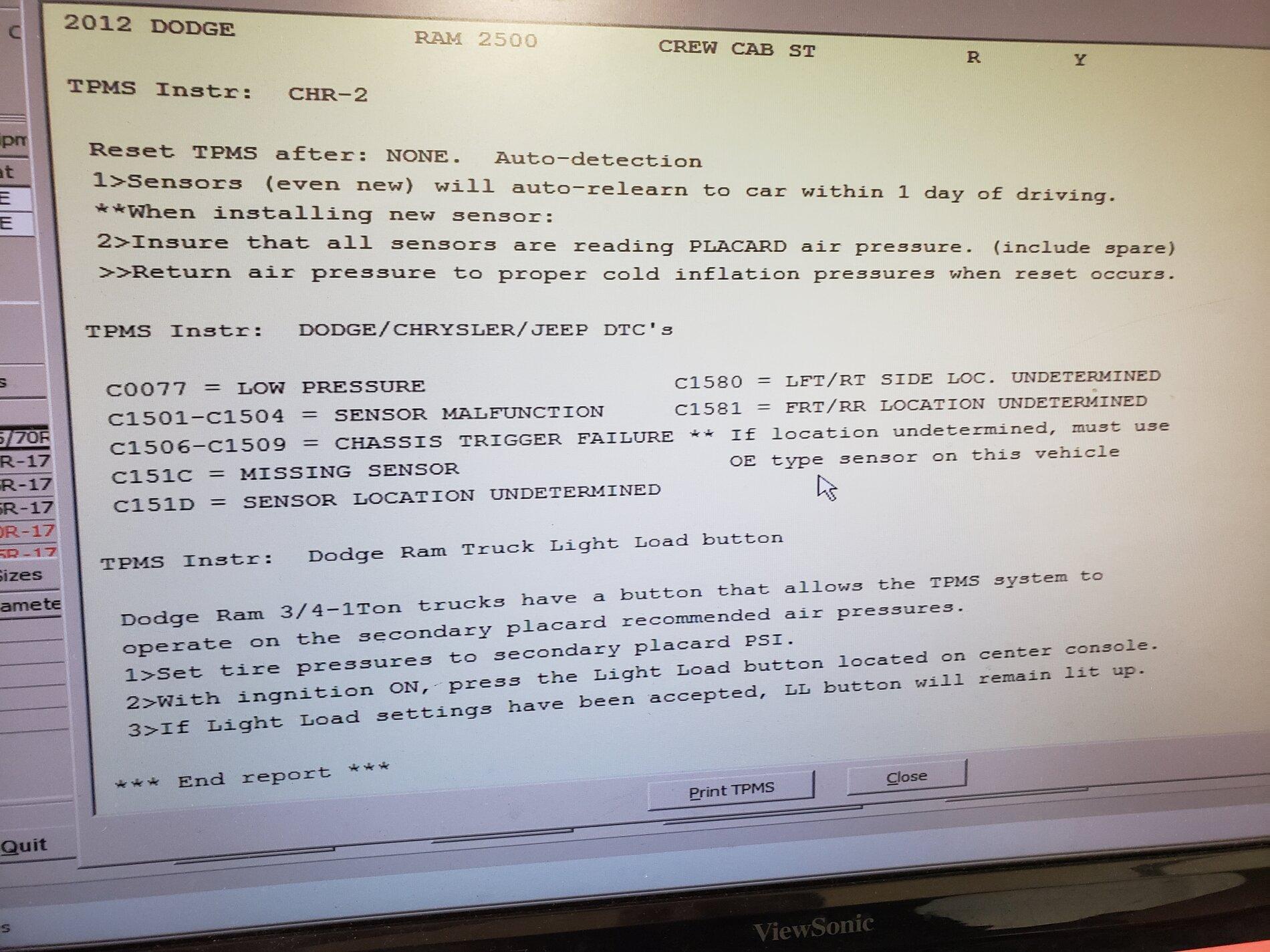

I got in my truck this morning heading to work and after about 10 miles the tire light flashed for probably a mile and showed service TPMS system but is still displaying all the tires and pressures. I also checked all my tires and found no nails anywhere.
I've even checked the pressures manually in each tire and they all read 75psi. They are showing 77psi in the front and 81 in the rear on the dash so maybe that is the issue. I have an appointment with discount this morning at 915am to see if they can get them fixed but I have a trailer with me and there lot is smaller near me at Midpark and 75 in Dallas.
