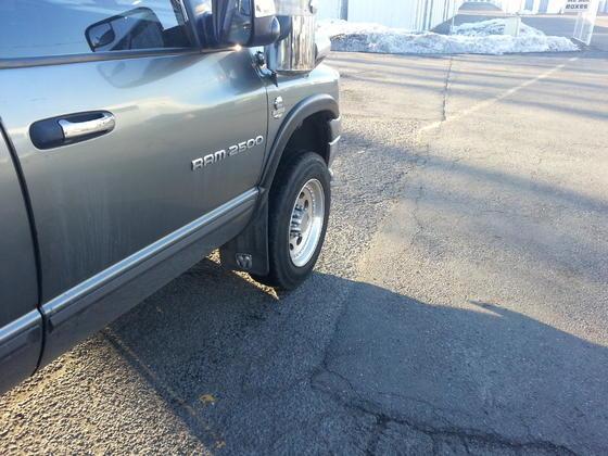

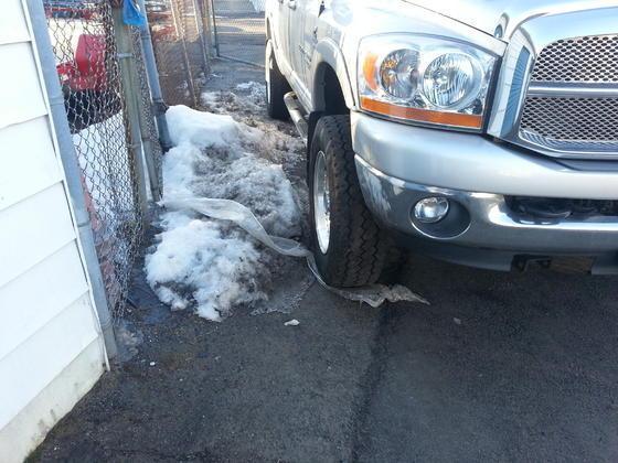

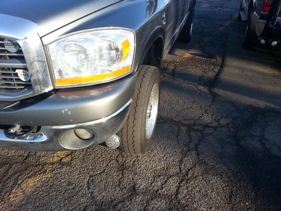

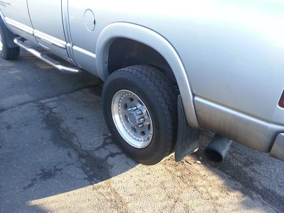

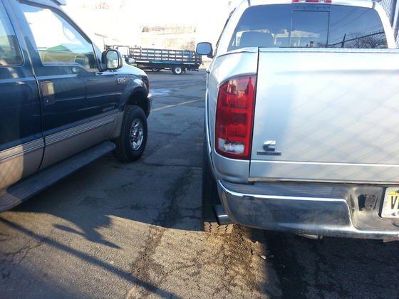

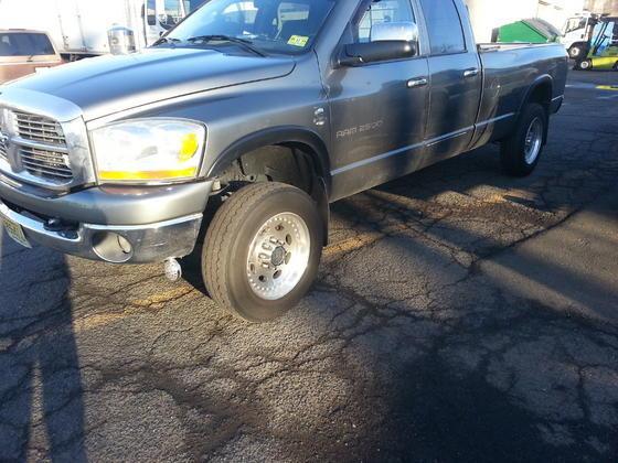

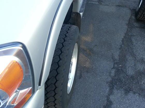

I've had Vision 19. 5's on my truck for three years now. Not a problem to speak of. I noticed a huge difference towing with these tires opposed to the stock wheels. They feel very sturdy and my stock set up when towing heavy felt like i was going down the drag strip with slicks running 10. 80's. I have 245 tires on mine and my buddy has 265's on his. Mine have 134,000 miles on them so far and are close to the end. Will be replacing with 265 Michellins this time. My friend has the Yokohama Y303's. If anyone is interested i can take a pic or two tomorrow and post.
SShafranko, I would really appreciate some pictures. Can you show a picture looking down the side of the truck to show if the wheels stick out? Also who mounted your tires if other than Rickson? Did they jump at all? I drove a lot of single axle UPS vehicles with 19. 5's that would go down the road with a constant thump thump thump like the tires weren't mounted right on the rims. Thanks, Chris
No problem. I will take some pics today and post tonight. Mine rode totaly smooth until my front end wiped out recently. I need new ball joints, u joints, tie rods etc. This will be my second time doing everything except i never changed lower ball joints yet. I have 245,000 miles so i can't complain i've been lucky. One thing i would recommend is to get a good set of tires. Don't buy cheapy chinese or whatever brands because you may run into the problem you are speaking of. I'm not sure i don't buy cheap tires i'm just guessing.
I forgot to mention i also have the centromatic wheel balancers, but i never really tested them to see if they actually work by taking them off and noticing a difference.
The silver truck is 265 tires and the charcoal is 245's. Let me know if you need anything else. Also sorry if i missed it but why do you want to go to this set up? I wouldn't recommend it unless you have a reason. My reason was because i pull a dump trailer and various other heavy trailers and they are much better for that and also i frequent a landfill which i used to get flat tires every other time i went there with the stock set up and with these i pulled framing nails out of them and haven't had a leak in three years:)
Yep, they stick out too far and make it look like a Chevy wannebe dune hopper. As many problems as these fornt ends have that just adds to the issues. Not enough back space to make it worth while.
your right better off sticking with the balloons, probably less problems in the long run. That's one of the reasons i say don't do it unless you have a good reason. It does change the ride considering your going from a 6 ply piece of rubber to a 14 ply tire. Also weight should be taken into consideration. These things weigh a ton i can't imagine how heavy the steel rims would be.
