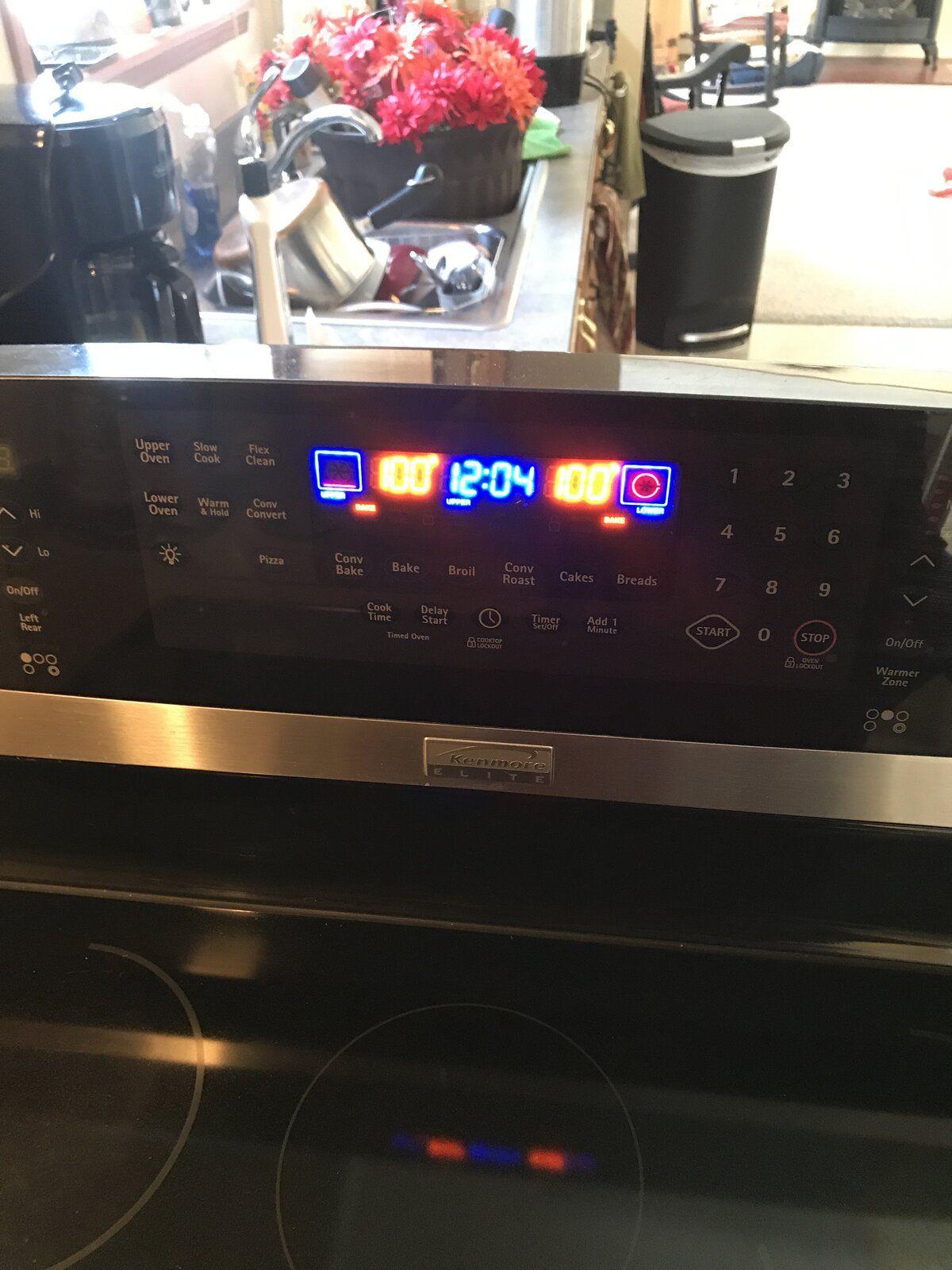

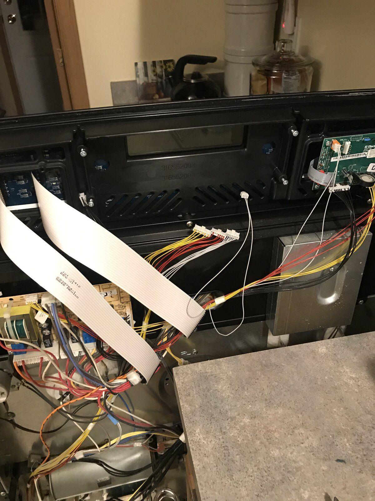

Well, they found the code. Communication error between control panel and the board. Told me to put it back in and see if it straightened out. Sometimes disconnecting and reconnecting the ribbon cables will reset it.
If it doesn’t work then I order the board..
Running down to try it now..

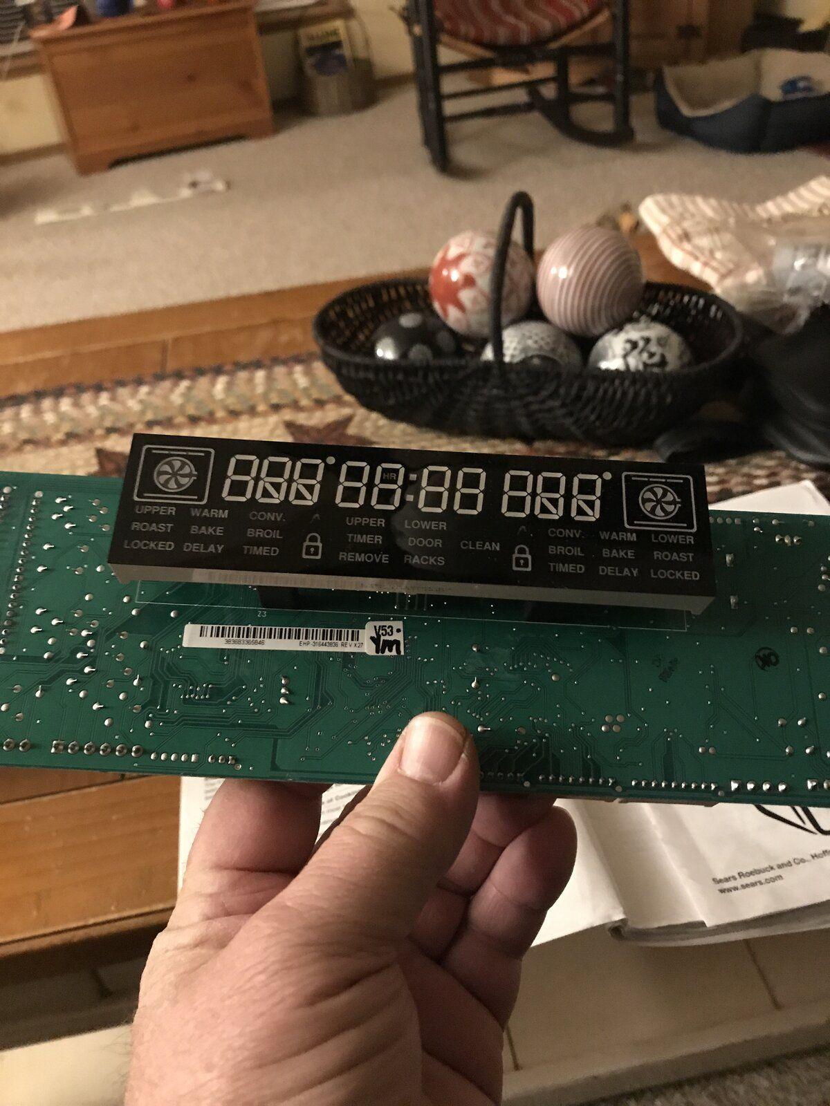

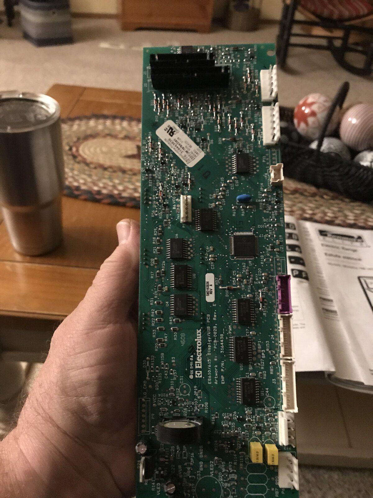

Well finally got back to this...new control panel board did not fix it..so I’ll sell that on ebay.

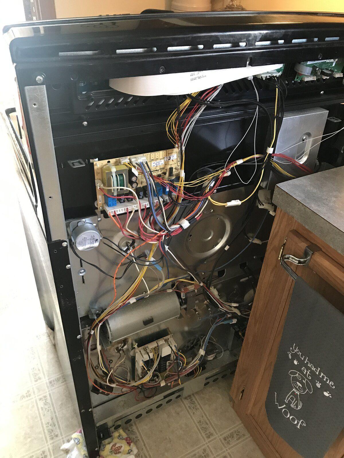

Ordered a used burner relay board even though the code did not point to that. $45.00 including shipping. That showed up at work yesterday..put it in this afternoon...
That did it!! All good now!!
