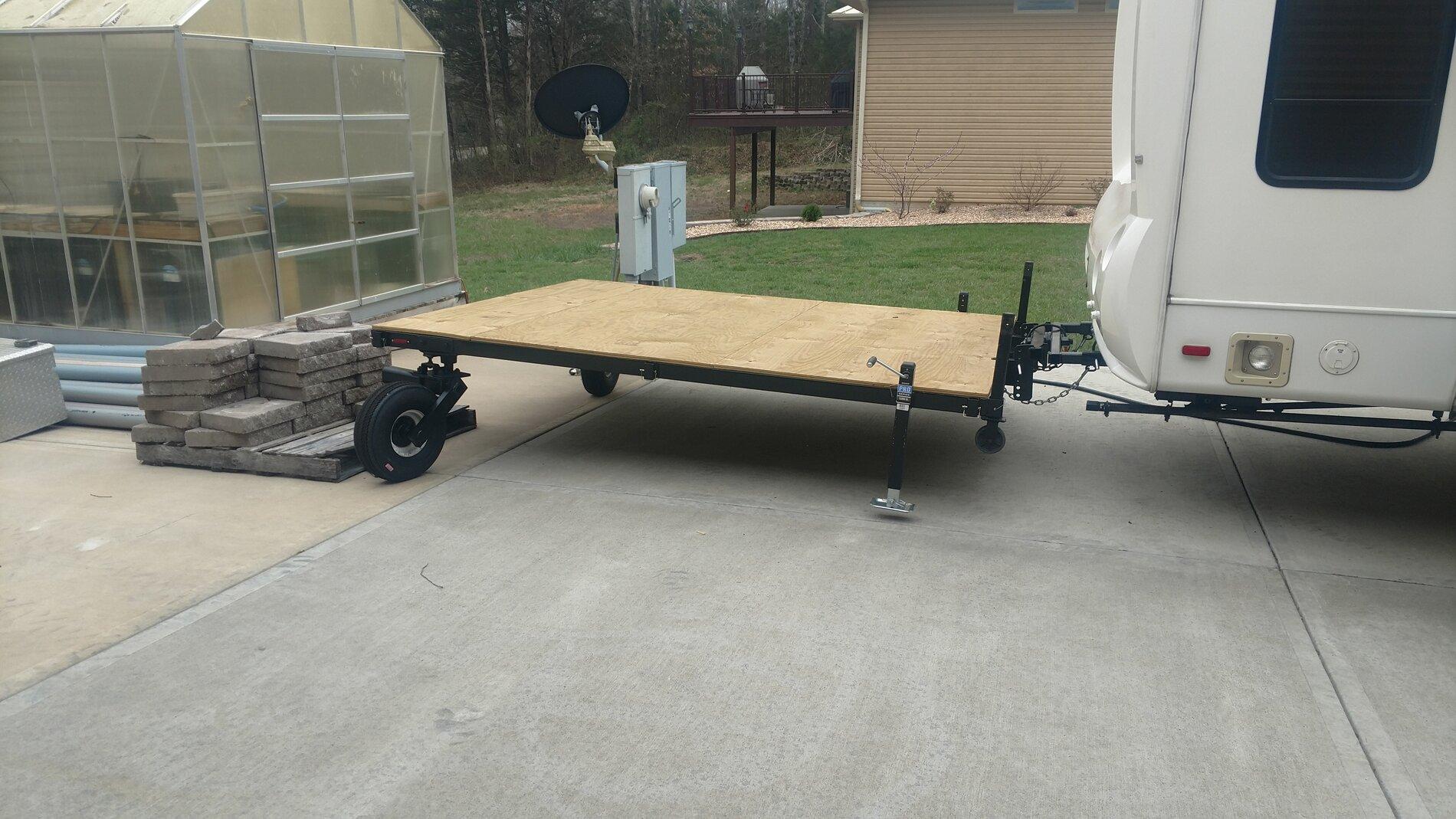

Another option to consider.View attachment 118416
Those are pretty popular in states that don't allow double towing, but like @NIsaacs said I couldn't imagine the tail swing with it extending so far past the axles. Lots of tight single lane roads where we camp. Plus it's useless as a spare trailer when not hooked to the 5th wheel.
