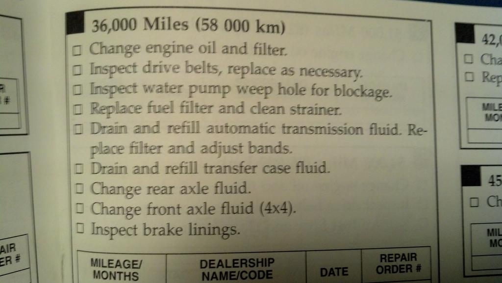

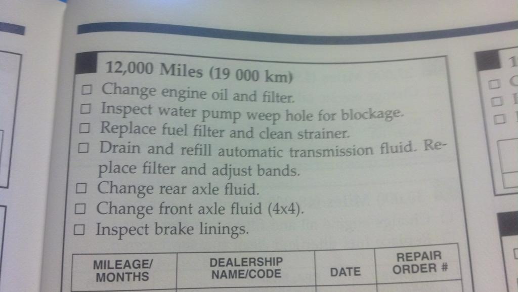

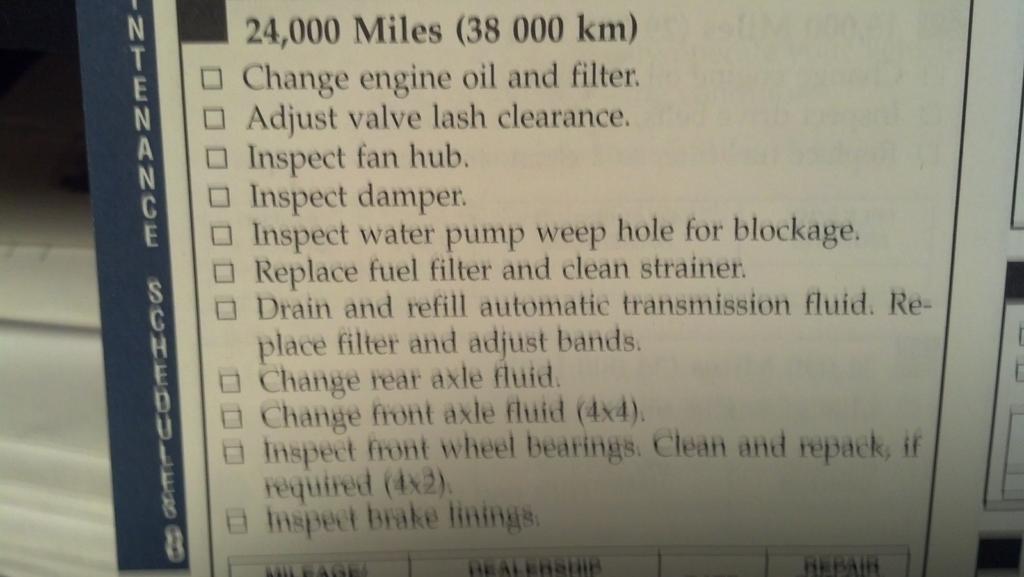

This is why the short service intervals
Is that a recomended service for the first 12k miles? I dont think that is every 12k miles, the engine oil/filter is not on a 12k mile interval and neither is the front and rear diff.
I'm sure its probably not the end of the world to not do it 12000 but as much bad luck as I had with automatic transmission I didn't dare take a chance and it still bit me in the a**
OK, that's under severe service or schedule B. Along with 3k mile oil changes. If you truly met those conditions then maintenance all around would be pretty costly, not just in the transmission department.
I do everything except the engine oil which I do analysis on each change also the engine is way over built for the application. The auto trany is under built at best
