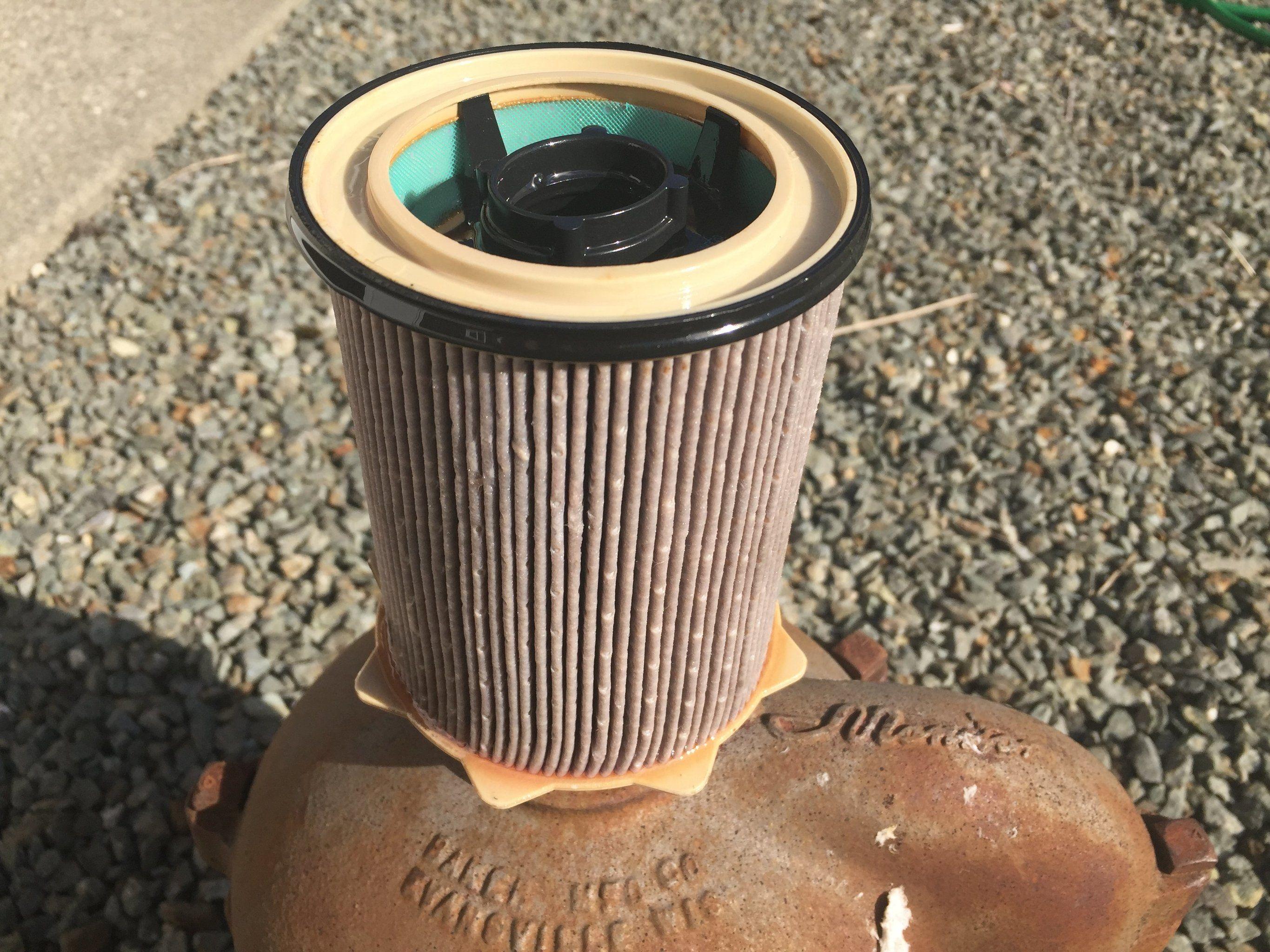

Take a look at a truck with a RAYCOR on it. The engine mounted filter still looks new when replacing at 15-20k.

I know some feel strongly about not touching the factory system and the 13+ system is much better than the prior but after 20k miles my filter still looked new after installing this kit. Some have concerns about the filters in the extreme cold. I haven't had any issues in the mid Atlantic climate.

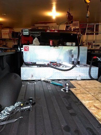

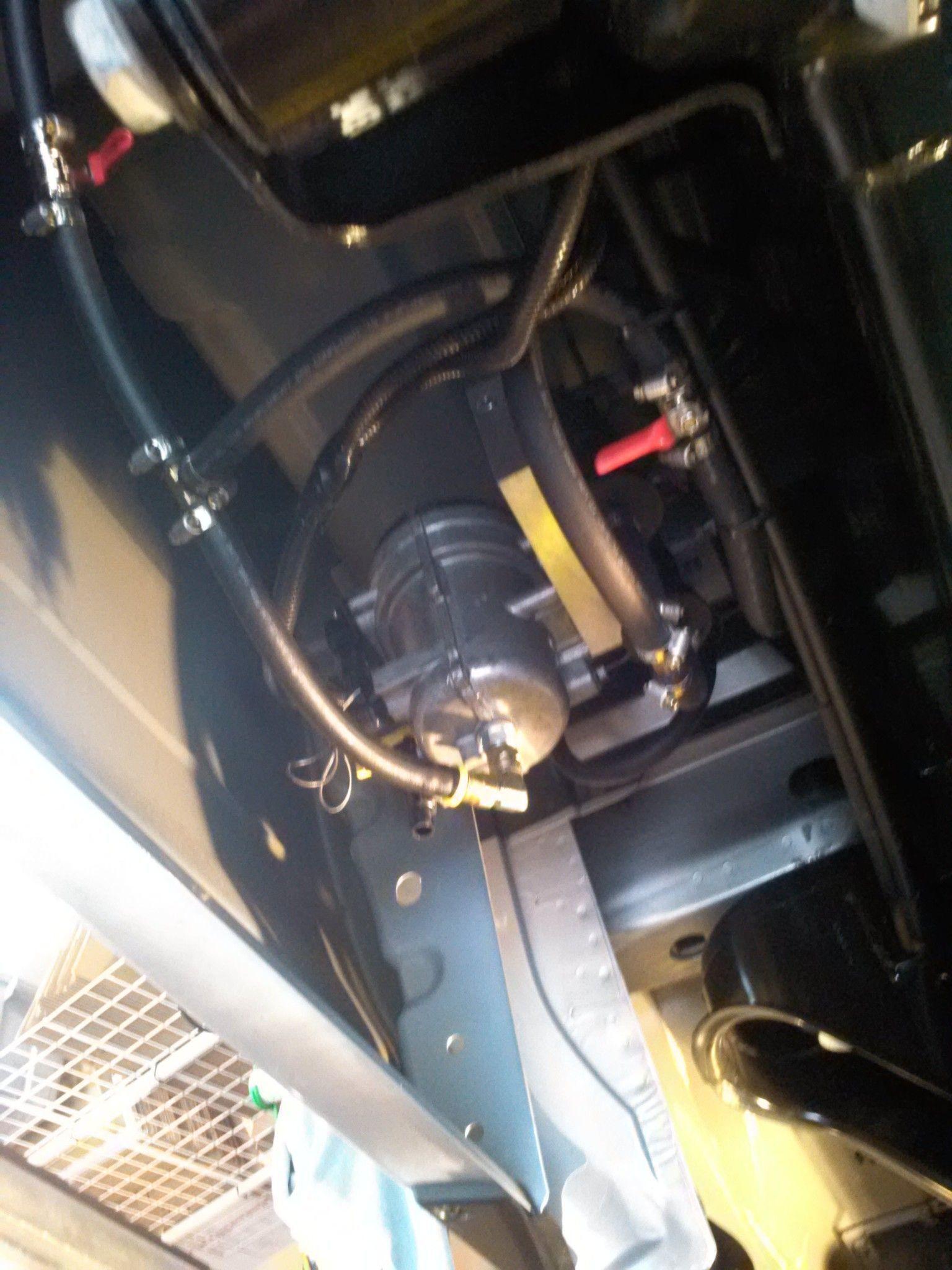

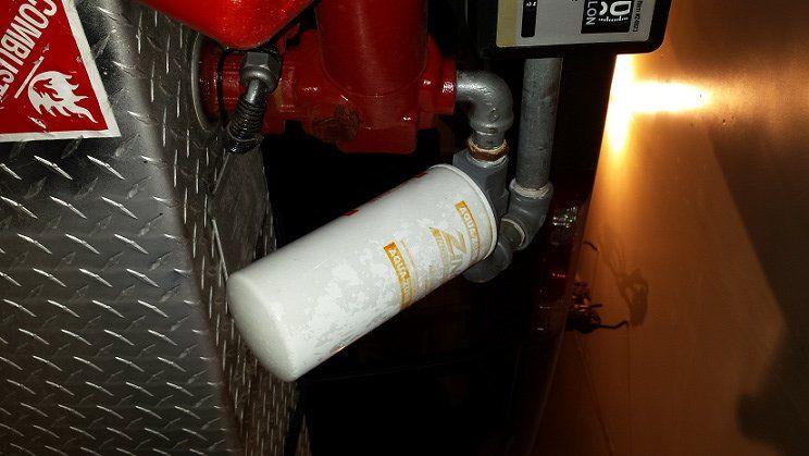

If you want to put the effort and $$$$ into additional filtration , theirs two ways to do it . Auxiliary filtration or bypass.
If your going to add auxiliary you should consider making it the backup to factory system, if your the 1 in a million to have the factory in tank fail under 10 years.

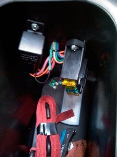

The Auxiliary system Pictured has automated fuel heating and is manual filtration and Backup Lift/feed for factory setup.

That's a really nice set up you have there! My motives didn't stem from a lack of filtration (even though I in a 12) but from the high cost of the nanonet factory filters. At 75 dollars each this kit will pay for itself in 2 years.
It does give a warm and fuzzy feeling when you open the filter and it's hardly brown at all - extending change intervals.
View attachment 109814 View attachment 109815 View attachment 109816
