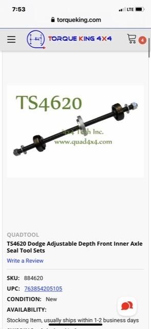

I'd have loved one when I changed mine.
But necessary, No, a helper with a broomstick and a hammer was my solution.
On the inside i had a big socket, the same size as the seal flange and I guided it while my buddy lightly tapped it in from the outside.
So, yeah, it's doable.
