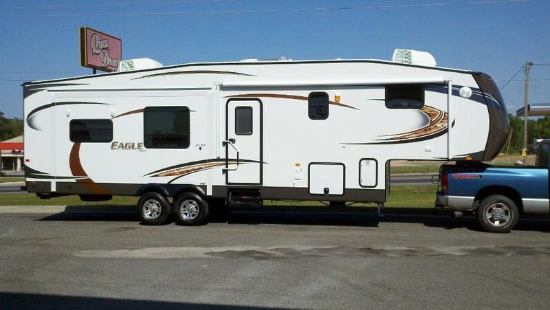

heres mine on a standard Companion but BEFORE the RoadMaster Active Suspension springs, as you can see, she was sagging a little.

I think its a camera trick...that pic was taken the day we brought it home so it was completely unloaded/empty but the nose was high and the back end was low on the truck. By the time the wifey got all 8K lbs of crap packed into it, the rear springs were screaming! Ive got between 5 and 6 inches of clearance between the camper and bed rails and the truck and camper sit level.
And it DEFINITELY needs washed! When should I expect your arrival with soap bucket in hand?? hahaha
Thanks for the picture. That is a beautiful rig. And it makes me think I will be OK with just the companion.
I have an 05 two tone same color, same off road 4x4 stickers. :)

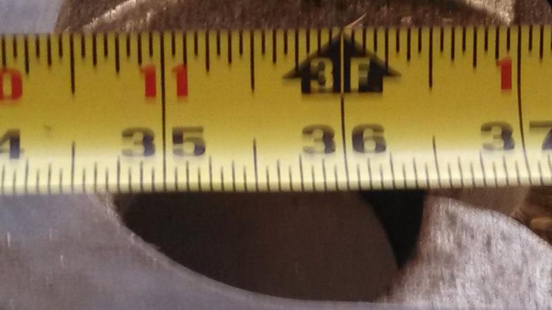

ok.. walked out and took a quick pull of the tape from centerline of the pin location in the hitch to the lead edge of the bed. Exactly 36". I will take a pic of it Friday when we get to the lake before I unhook with some measurements. Our camper is a 96" wide. I have hooked onto an older wider square nosed 5er with a short hitch for a friend. I think it was closer to a 102 wide... He couldnt get it into his driveway with his cc dually 2wd

Yes, the 36" measurement is from the bed rail to the centerline of the kingpin. I believe you will be ok. I'll take a few pics this evening.
I believe my turnover ball point is much closer to the cab, but the Companion offsets that toward the rear which increases it to 36".
OK.. gonna try this... Hopefully this is a link to a Photobucket account. BrewMark, there should be some photos in there that may help.
http://s1364.photobucket.com/user/r...3&page=1&_suid=139346113357703038123378027045
Thanks Wingate. Pictures were great. I think that one picture shows the post that goes in the turnover ball hole being at the back (point closest to the cab) of the companion. Looks like there is maybe 6 inches from center of that to center of kingpin plate.
So that helps. Thanks. Also answered another question. Was wondering if a spray in bed liner would be an issue with mounting the companion. That picture tells me it shouldn't be.
