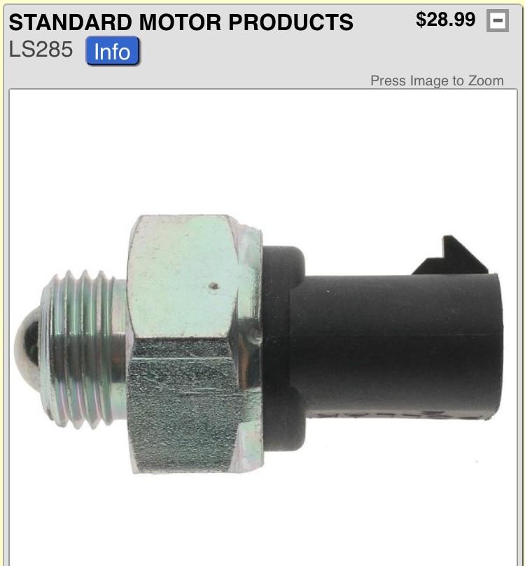

Anyone have a part number for the switch?
I see them priced between $12 and $50 which makes me believe they're not the same part.
Thanks to everyone that responded to my question. After checking everything and it all seemed to be working I did what "KATOOM" did and purchased a switch from Transmission Parts Distributors and it arrived today. Installed and now I have backup lights!!!
