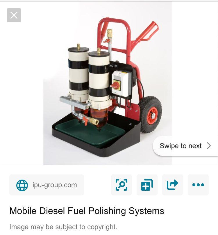

You need a good diesel shop with one of these.
Let me explain.
I’m a long time Diesel Mechanic- my Shop has one of these, and since I’m with a Government Fleet, we run wild experimental bio diesel concoctions. We’re always faced with contamination.
I’ve made up a few adapters for different trucks, and what I’ll do is tap in just before the primary fuel filter and either pull out the fuel with that machine and put fresh in, and recirculate or recirculate the existing fuel to “polish” out the water and contaminants. The filter will usually be a 2 micron with water wicking media in a coalescing housing that really separates the contaminates. This usually takes a few hours, and you’ll wind up with a perfect fuel system. You wouldn’t believe what we drain off the bowl of that polisher filter.
