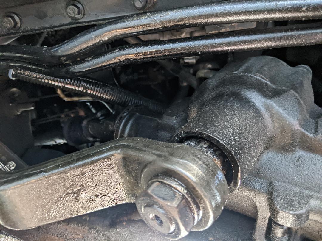

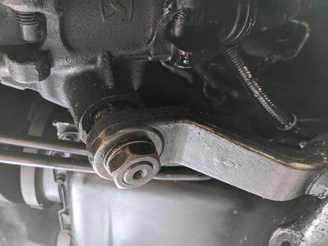

It is not leaking from there. It's leaking from the bottom of the steering box. Power steering fluid is used up close to a gallon a week, and I don't drive that much.
It is leaking around the spllined shaft in the picture. I didn't notice anything holding that big nut that attaches the steering knuckle (if that is the right term) to the steering. Can I just put a big wrench on this, or is there something else holding it on?
Any advice much appreciated
