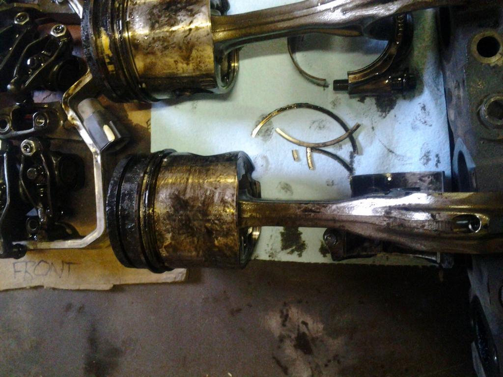

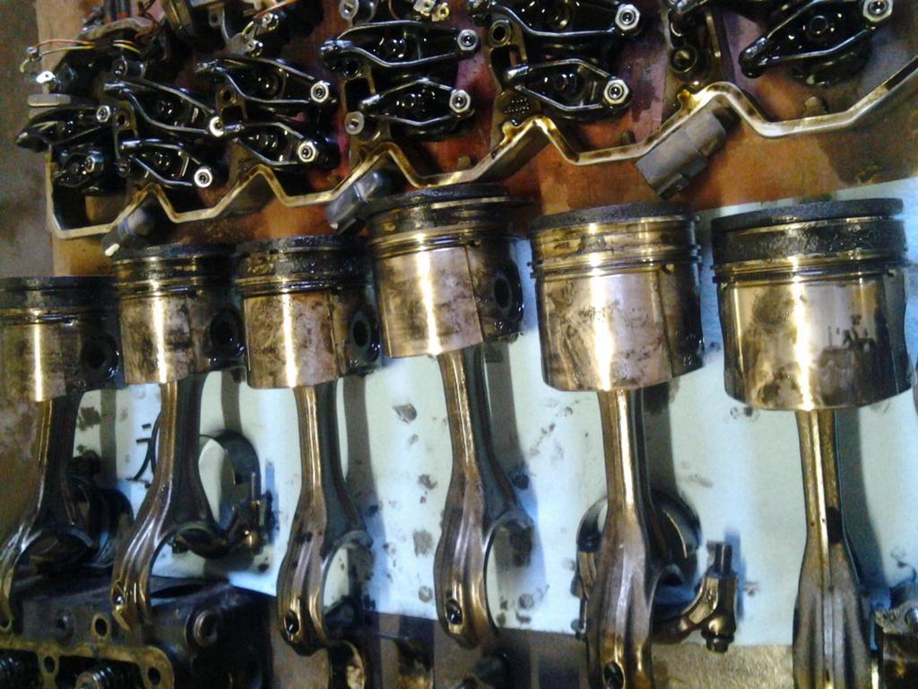

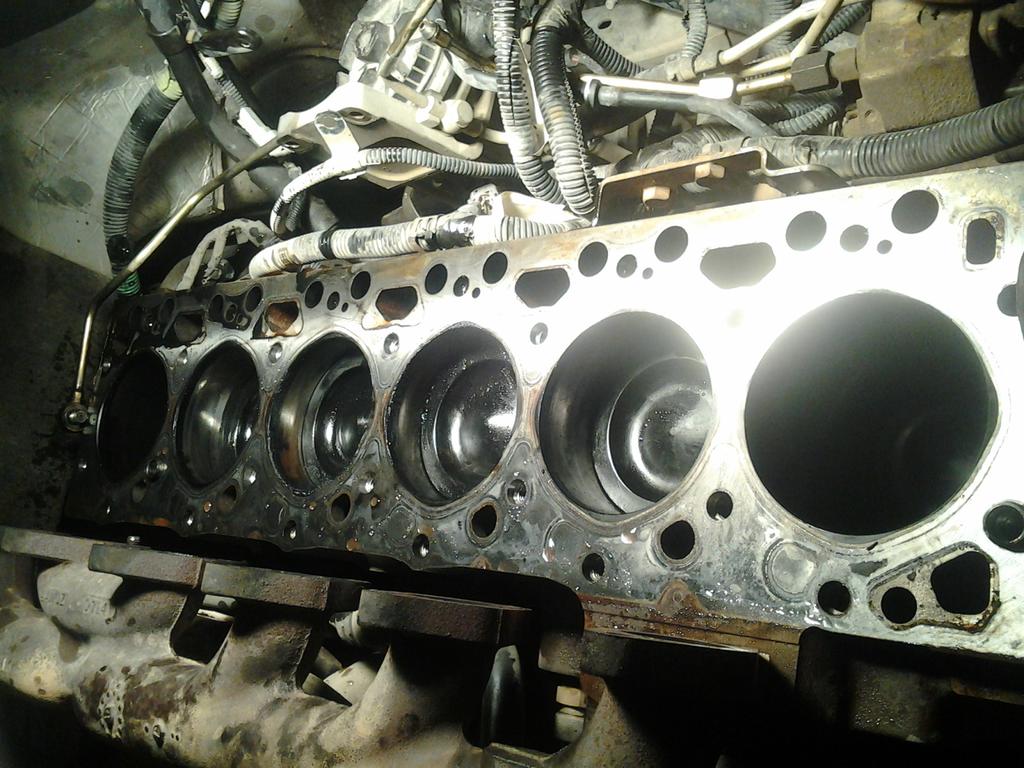

We decided to tear into it and see what happened. When I pulled the exhaust manifold off for the head removal #4 hole was wet with diesel so we knew that it was a dead cylinder. When we got the head off it was a nasty mess. #s 4,5,6 all had the piston bowls full of diesel and the injectors had so much carbon on them there was very little spray pattern on the pistons. #1 piston had chunks of ring stuck in the top of it, but luckily didn't hurt the cylinder. We pulled the oil pan and took all of the pistons out, and four of the six had broken rings. The rings were broke in five or six pieces each. Again no cylinder or head damage! I don't know how this thing ran at all, and especially that it ran smooth. He pulled a heavy trailer from Nebraska to Idaho and really only had two good cylinders. We bought one new piston, new injectors, bearings, and gasket kits. We honed out the cylinders, put it all back together and it is a whole new machine! It has no blow by, and way more power. That was on new years eve that we got it running, And today he took a load of horses to Nevada and it ran great. Fuel mileage was back up and he could pull the hills at the speed limit. We got the injectors from TC Diesel, and they were very helpful. They had fair prices and a lot of good advice on the repair. It is good doing business with people like that. Thanks to all for the tips and advice, now if I can get the pics to attach.
These are all I took. My brother took some that he will have to send me. I forgot to mention that we did all of this in frame. It really was not that hard.
Got one sitting one the floor of my sons garage with injectors that look like that. Guessing we are going to have some broken rings when we tear it all the way down.
That looks like it was rode hard and put away wet. Farm truck?
You were spot on with the diagnosis. I am glad that he quit driving it before it got worse. No his is not a farm truck, but we do have a couple of those that have a pretty tough life. One is a '98 12v 5sp that is one of the toughest trucks I have ever seen. The other an '05 nv5600 That got new injectors and good filtration a long time ago.
The 12V's will run on fuel that will kill a CR on a short trip. These things are very picky about clean fuel and everything working as designed or you see the results. Extra filtration and additives a must or things can go bad real fast. That was extremly lucky one or more of those pistons didn't look like somebody had taken a blow torch to the top of it, expecially on the deep spray bowls.
Glad it wasn't a total melt down for y'all.
