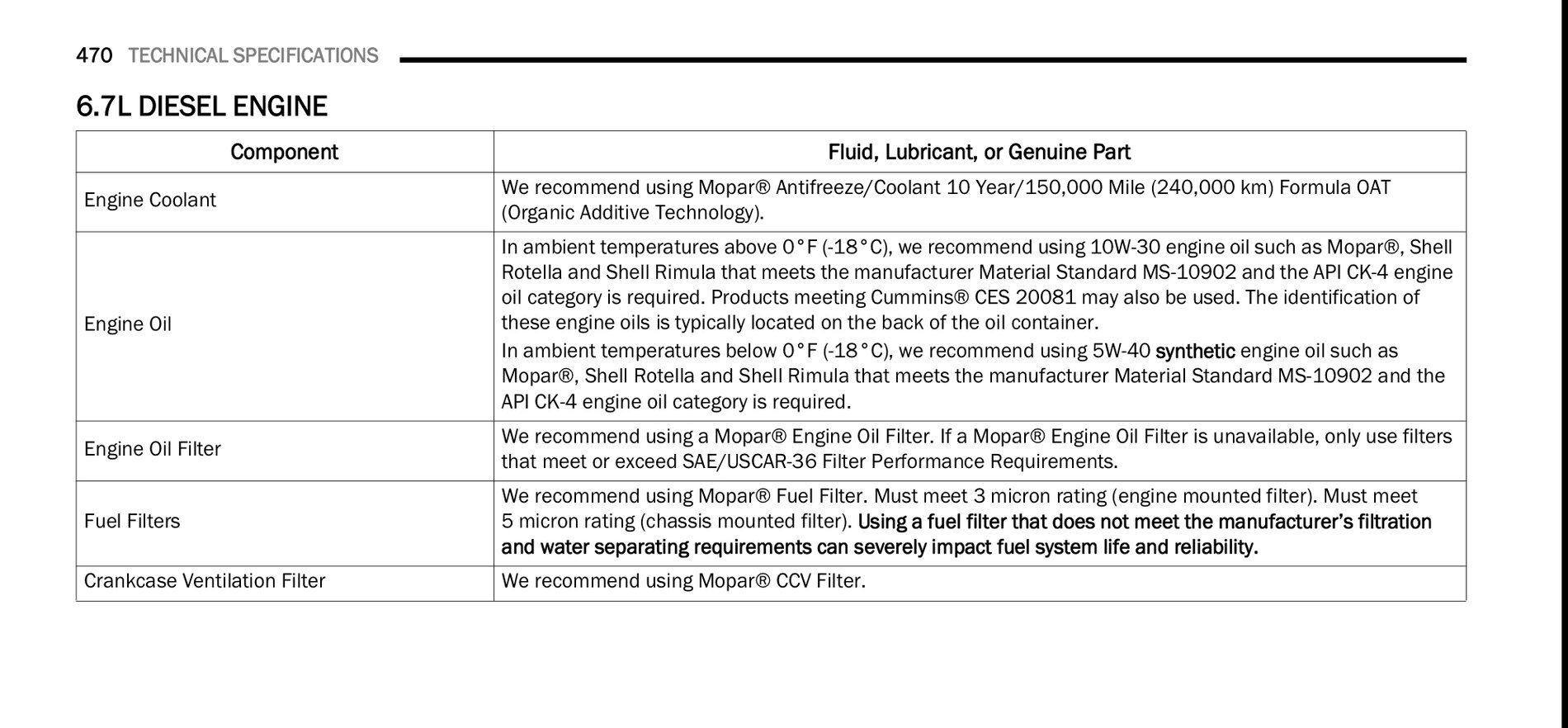

They can require you to use a filter than meets certain specs. If the Baldwin meets those specs then it’s approved by Ram. If you look in the owners manual under fuel filters you will see this requirement. 3um for the engine mounted and 5um for the frame mounted.
On page 466 of my owners manual it has this about filters and I quote: {You must use Mopar®/Cummins® approved fuel filter elements in both your engine mounted filter and frame mounted filter.} no where does it say Mopar/Cummins specs...

This is the ‘22 Owners manual.

Page 470 has the requirements, that’s the important page.
That being said the specs listed above are a little ambiguous for meeting the OEM requirement.
I’m a big fan of Baldwin filters, but would need to see something better than the specs above to run them in my ‘22.
