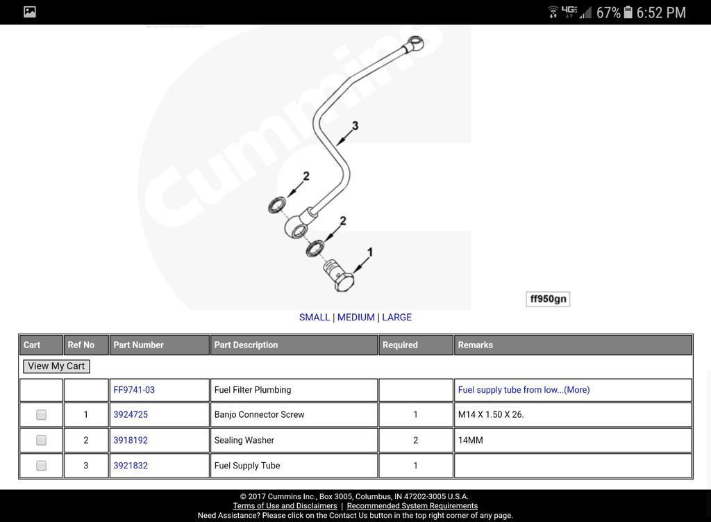

I want to replace the return fuel line behind the fuel filter. It's been way too many years, and I want to get ahead of things.
What size banjo fitting is on the overflow valve?
I'm getting measurements in the 14mm range, but what google has turned up isnt making sense....unless there are different type of banjos.?
TIA
PS I'd like to go to an AN fitting, then to braided stainless.....
