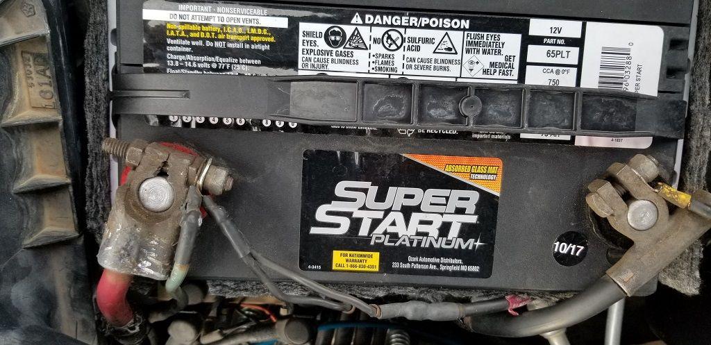

One picture alone should sell you on AGM's for your Dodge Diesel. Look how clean the battery top and cables are given the age of the battery!

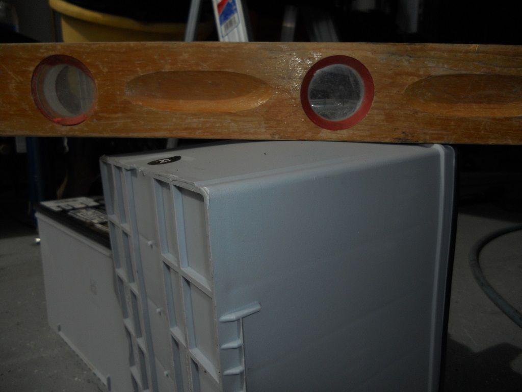

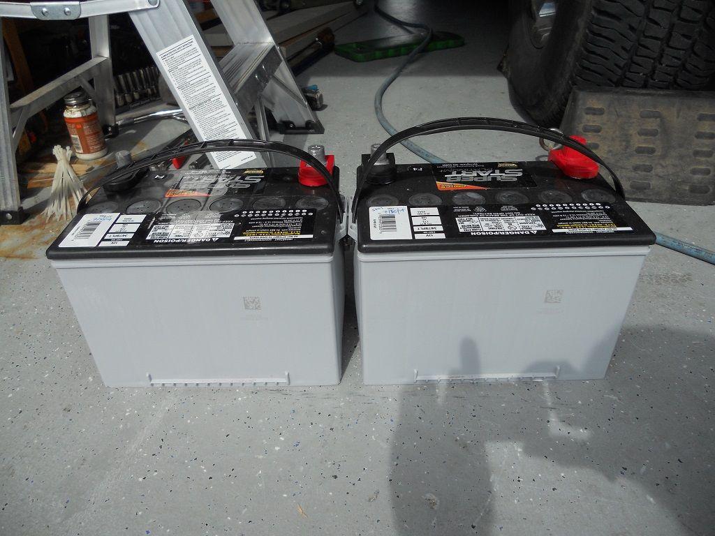

It's possible AGM's could last you longer. Their reputation is for doing so. However I do not buy AGM's for long battery life anymore due to the reduced life from high heat. Long life from Red Top AGM's is now the exception rather than the rule. Further East Penn/Deka AGM's couldn't even take the heat for Consumer Reports let alone: get out of "My Kitchen" because you can't take the heat. This pictured ballooned set scared me on the battery tester as the voltage suddenly dropped off then would recover. 6 months old and sudden cranking speed reduction indicated a bad battery, again. Yes, returned for refund. Used in a 1993 GM diesel.

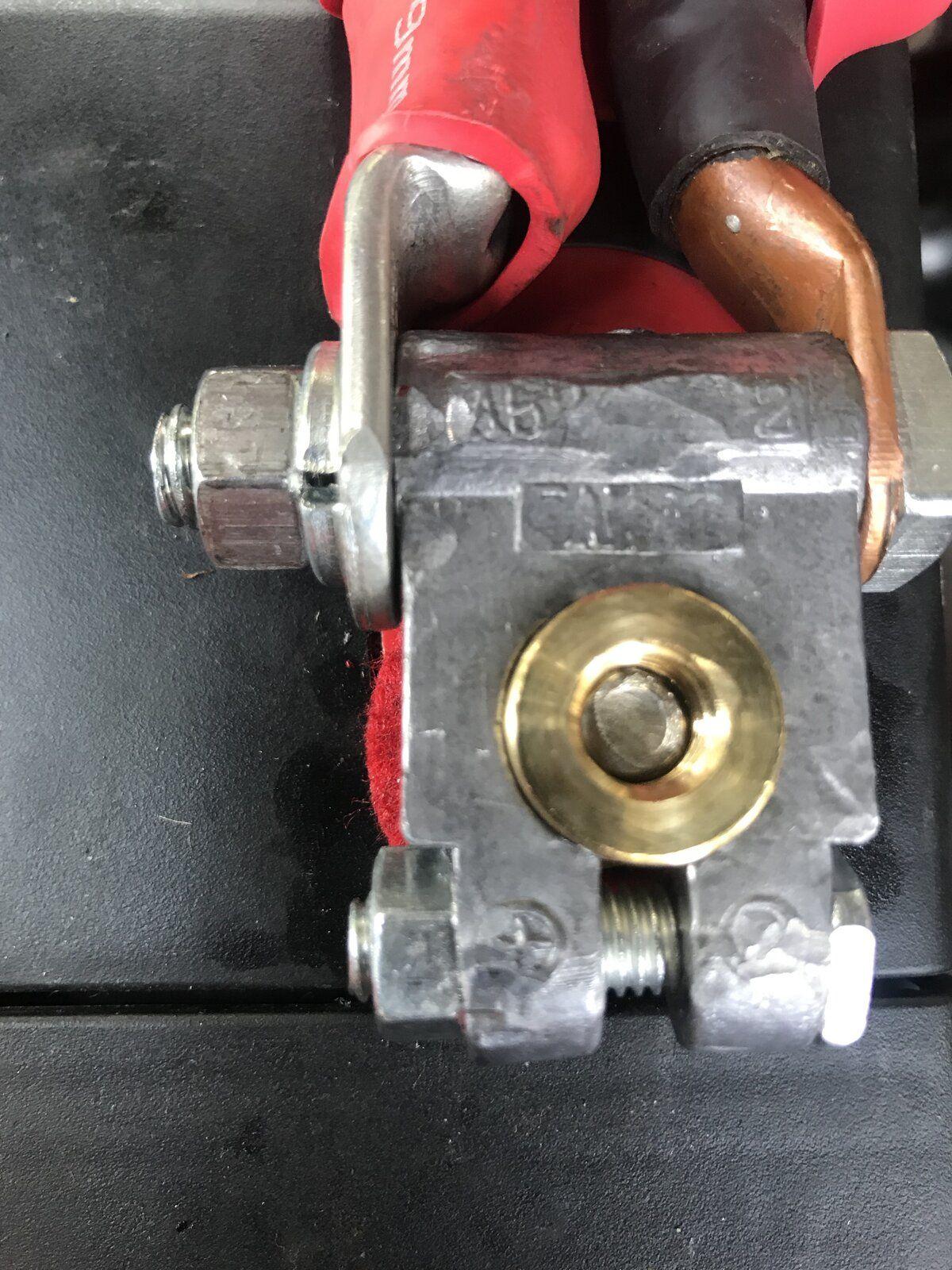

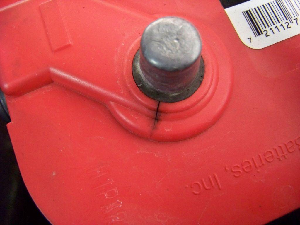

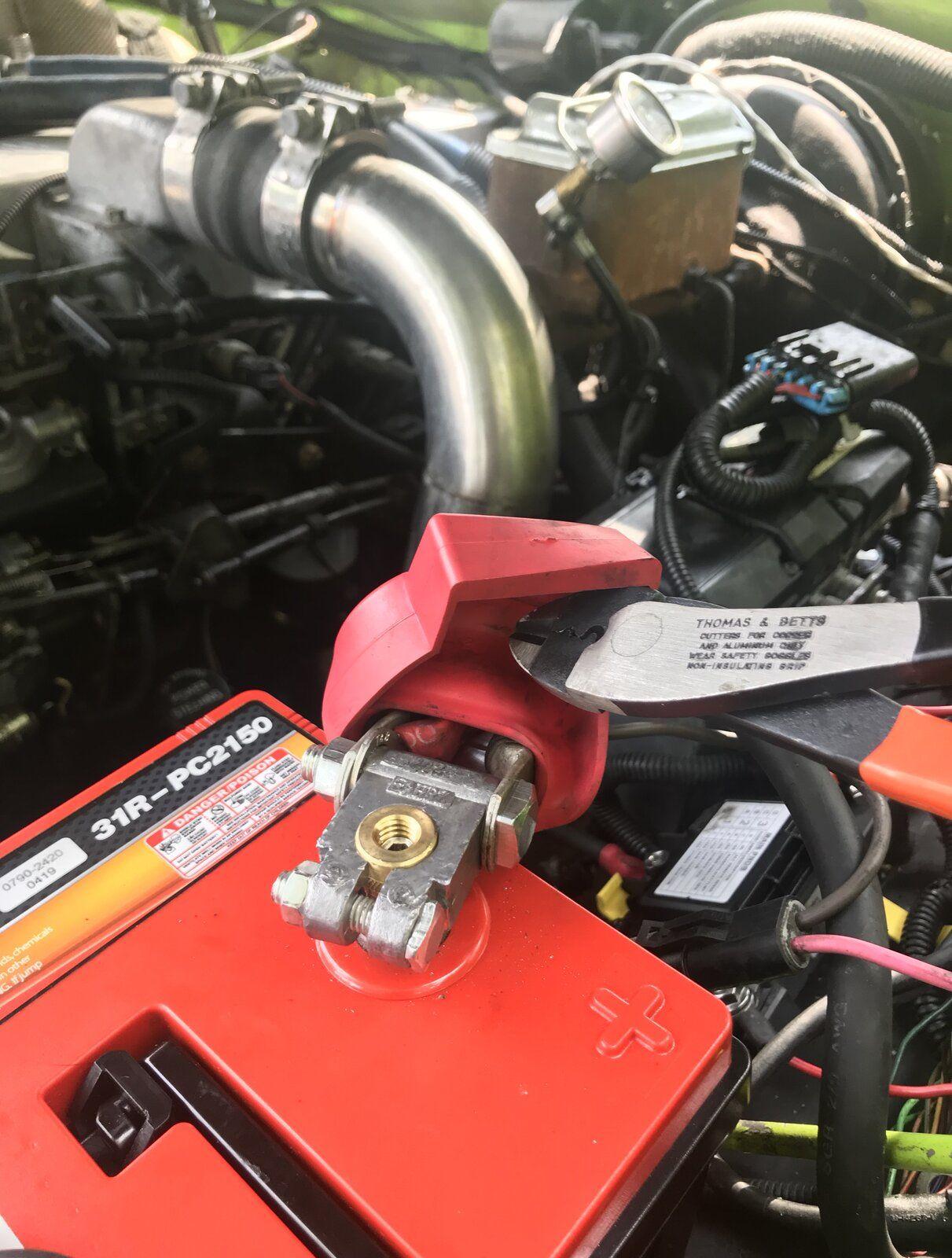

Spillproof doesn't mean leakproof as I have had a couple Red Top's leak around the terminals and eat the battery cables. Example below. GM side post used below so no load on the top post...
