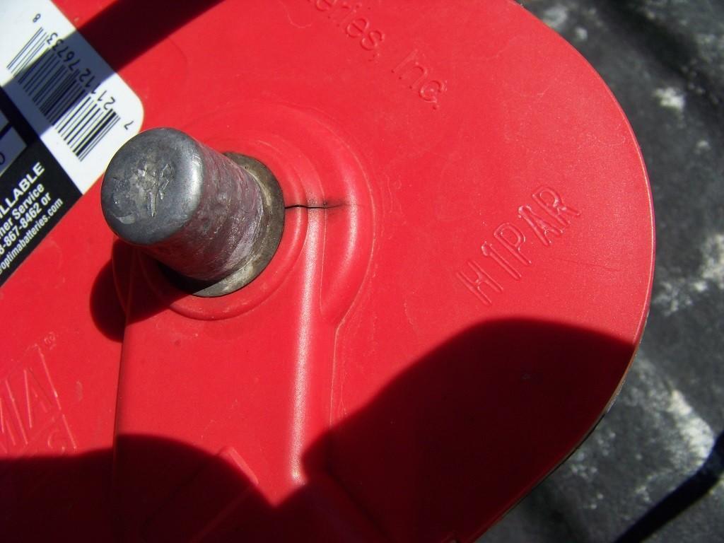

As far as lifetime in the extreme 105F+ heat: Not that I have seen in diesels. Every 10C rise in temp cuts battery life in half.
In the last 20 years, like winning the lottery, only had one Optima go the distance (7 years) in a garaged gas rig driven by retired folks, but several not so long life failures also in gas rigs. (Shorted cells some taking the GM alternator out with em.) I gave away the last two Optima's I couldn't get a refund on as they all were cracking and leaking from their (unused) terminals. The 7 year old battery was also cracked at the terminal, but, not yet leaking. AGM's don't spill, but, like a drycell flashlight battery can slowly leak.

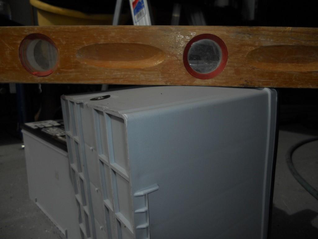

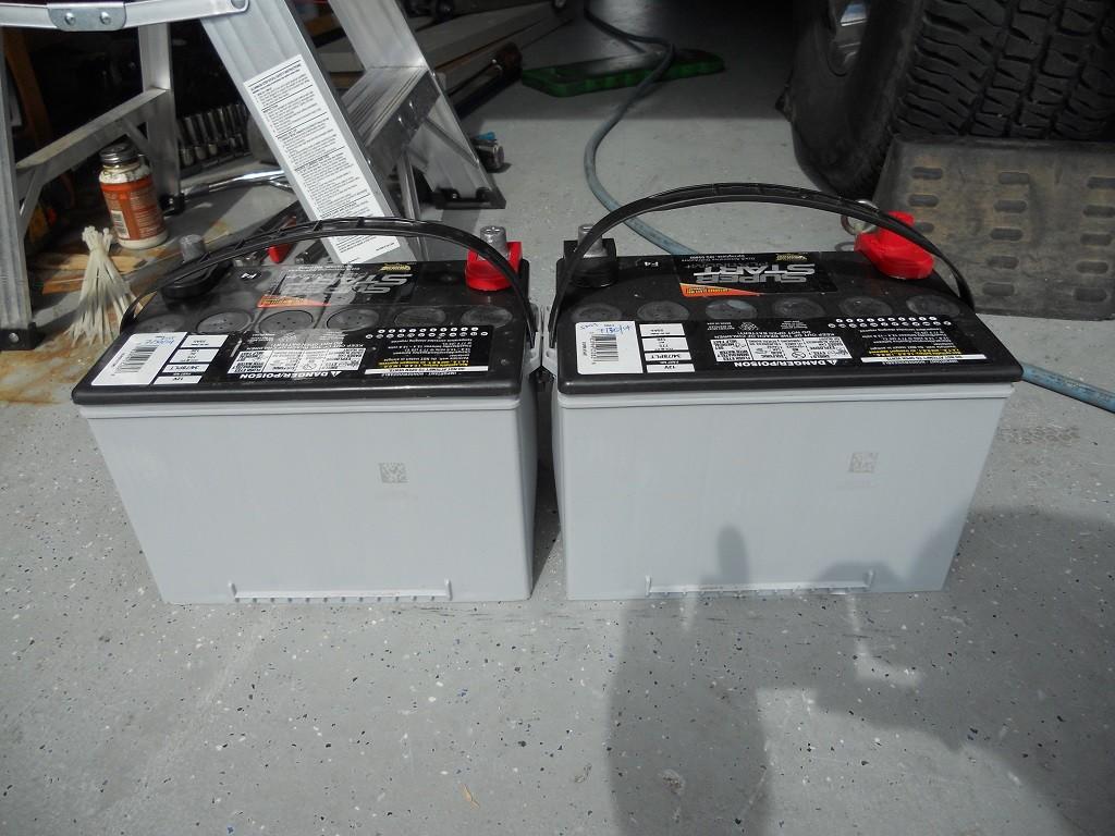

Yeah, AGM's can vent. Shorted cell on an old charger that will blast a battery that's at 10V or lower. Open back door, trip the breaker outside, and then take video and that's 10 seconds longer than I wanted to be around that hissing snake...

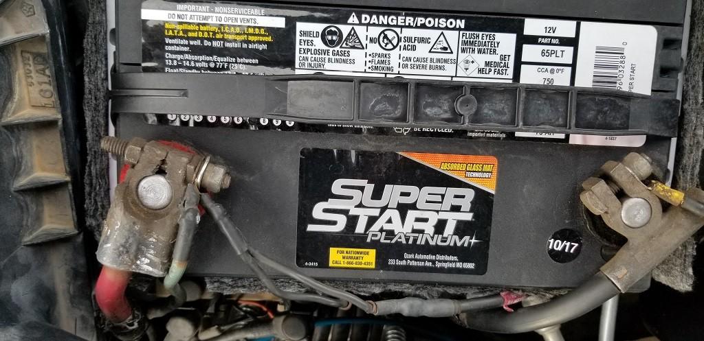

Deka didn't even pass Consumer Reports heat test and one set died early for me in the 1993 at 3 months. The 2003 Dodge diesel Deka AGM's did better: made 1 year 9 months before I sold it. (Got tired of the acid always all over the battery tops on the 2003.)
My 2003 Dodge RAM. Note 1.5 years old in this picture and no acid build up on top.
For the record my 2018 RAM sat 5 months with 15 miles on it at the dealer. I am sure that didn't help battery life. The driver side battery would drop 2V on a load test at 1 year and 11 months old.
So I am really curious if the Odyssey will do any better. Better would be 2+ year life and write home about would be making it 3 years.
