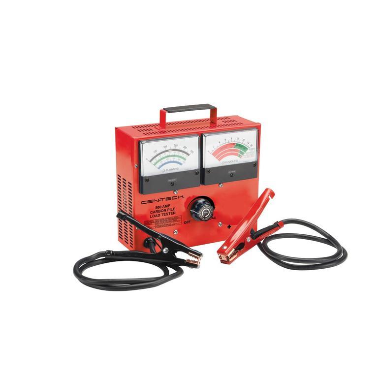

Yes, definitely test batteries independently, and I like the carbon pile load tester like the cen tech unit above. Once the battery has been charged properly, a hydrometer is the best tool to check each cell. Good luck in the weather BIG. It's coming this way!

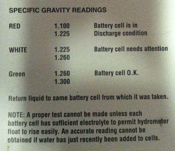

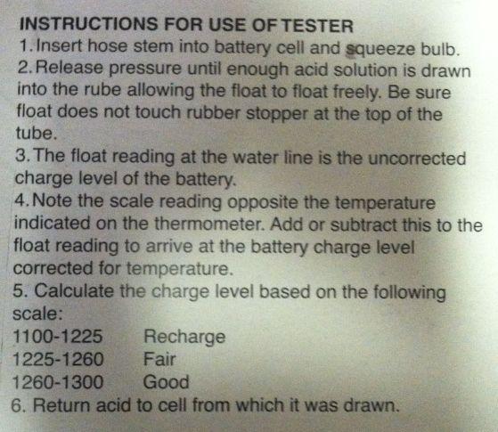

Thought I would post this regarding the temperature compensating hydrometer as it is a handy reference. This is for the McMaster-Carr unit but can be referenced for the specific gravity readings.
