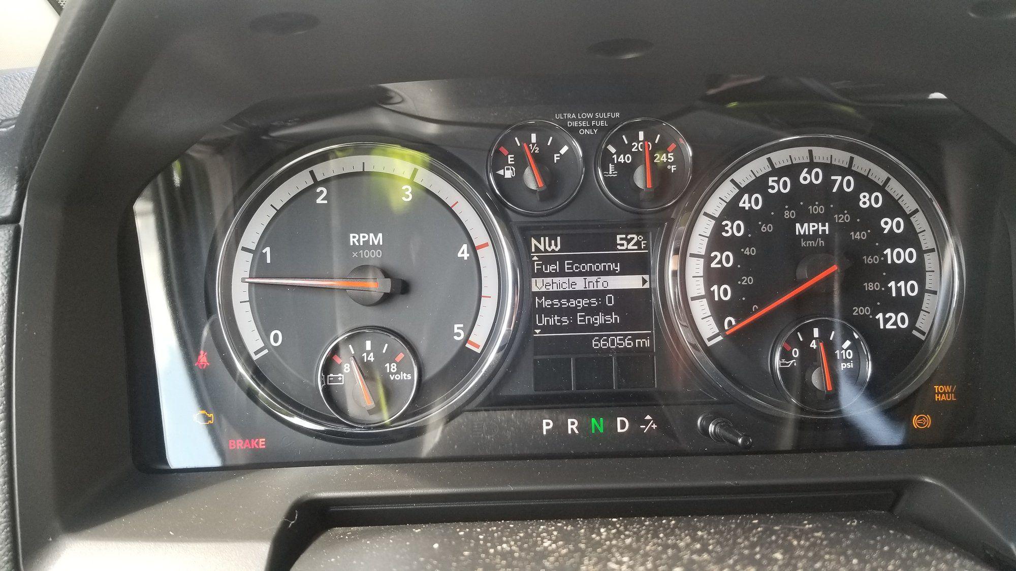

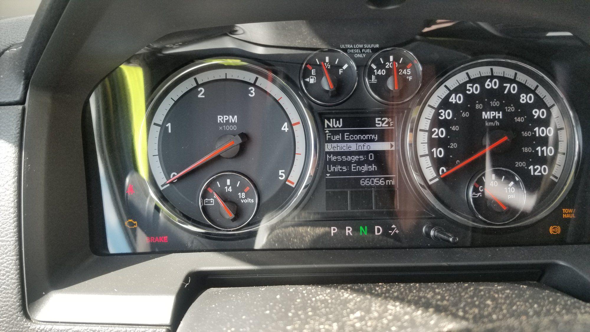

Can anyone tell me what the battery gauge actually measures? It's reading just above the "8", not quite to the line between the 8 and the 14. Presumably that line is 12. I would figure when I turn the key on it should be at or near the 12 line than jump to the 14 line when running. Is that a fair assumption? As stated, mine stays between the 8 and the next line. I do have a USB charger with a voltage display that reads 12 - 14 volts. What could cause the guage on the dash to read low? The gauge cluster was just replaced by the dealer due to lamps being out. Thanks in advance for any and all suggestions on this.
The instrument/Dash Module May need to be re-flashed. They do read about- .25-.75 lower than actual, Yours is Way off. It takes some time to move up after starting 30-60 seconds. The battery sensor module checks the condition of both batteries on 2013+ I would need to look into 2012- to comment on that year.

Sorry for the glares but the point still remains. This image is while the truck is running (obviously).

I find it hard to believe that after replacing 2 batteries with new ones the volt meter would be reading that low, even with an error in the gage with the engine running. There's something else going on there.
Prior to replacing both my batteries when they were weak, once the CTD fired, the volt meter would recover fairly quickly to beyond 12 volts.
I think I would look at the charging system, alternator output etc.
Good luck at the dealer.
Check the small cable from driver positive to TIPM. Had corrosion on mine that caused low charge indications.
