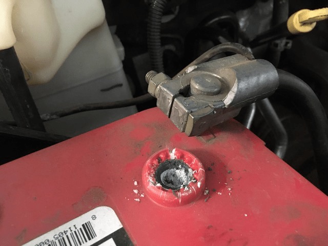

Optima quality is definitely gone. The last two sets in my truck lasted two years. I had an older yellow top Optima (Colorado made) in a Jeep that was still good when I sold it 8 years later.
The latest failure below. I just replaced them with plain ol' Interstate Batteries this time with a 3 year free replacement warranty from costco. I've given up on Optima.

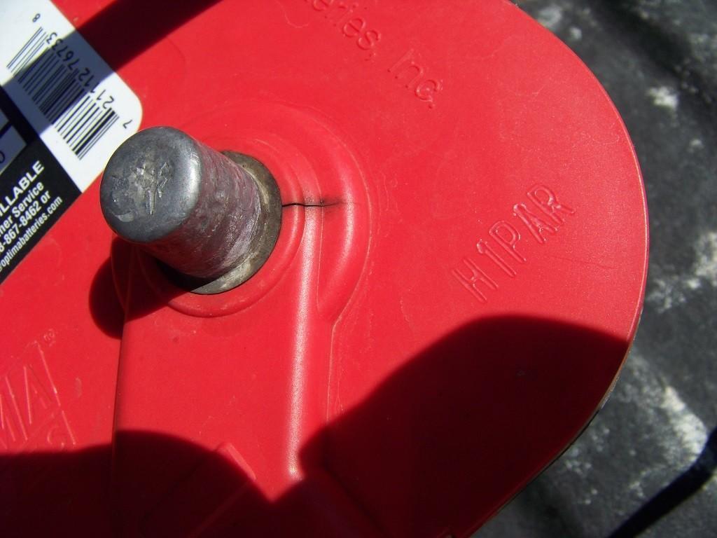

@GrantP Now I don't feel so bad. This is a crack that was starting to leak acid and the battery(s) that was warrantied for the ones above. Had one optima eat the battery tray and new cable that was slowly leaking out of a side post.
