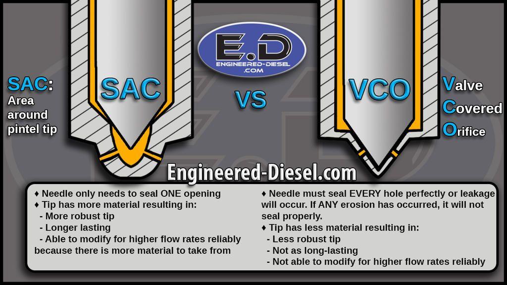

Can anybody speak to what BBI actually changed to make these better than Bosch as it applies to an '04 ? I'm in the market to replace my injectors fairly soon ( 150k+ with factory filtration ) after I add secondary 2 micron filter and am particularly interested in better fuel economy. What is it that CARB says no about with regards to these injectors ? I want to stay legal for emissions testing, but it seems from what I read that BBI .5 passes.

#1 difference and this is where emissions go out the door is the SAC vs. VCO. BBi's use SAC and others (like our OEM design) use VCO. That bubble of fuel under the nozzle is an emission source as it evaporates rather than burns. The emission tests we have to pass are not as strict as getting the engine emission design limits certified with the government.
Does the SAC nozzle cause idle haze?

From big-bang-injection.com website:
They are detuned to lower emissions and exhaust gas temperatures. An increase in fuel economy will be noticed as they have a shorter injection duration, with the same energizing time as the OEM injectors. This makes the Stage 0.5 a perfect towing injector.
Since injector duration is a product of ECM driver, how is this bit of shorter injection duration magic happening ? I emailed big-bang-injection asking if there are emissions reports or other test data to support the claim of lower emissions and exhaust gas temperatures and how shorter injection duration is possible when this is controlled by driver in ECM. I'll update this post thread when I hear back.
From email reply:
"Our Stage 0.5 injectors have lower emissions and EGT´s than Stage 1 injectors. They pass the idle snap tests without tuning and we also have customers in CA that reported to pass CARB emission testing there.
We also want to get the CARB approval soon for them.
We have done several emission tests in the state of Washington with Stage 0.5´s and Stage 1´s. (Stage 0.5´s pass the test without tuning, Stage 1´s pass with tuning)
http://www.bigbanginjection.com/images/Emission-test-results.pdf
To your question about duration…..
Yes the ECM adjusts the pulse width but every injector needs hydraulic and mechanical time to close after that electrical current is shut off. In case of the Stage 0.5 injectors the time from “end of current” until the nozzle gets closed is shorter than it is with OEM injectors. That gets you a shorter than OEM injection duration with the same electrical duration.
If you have any further questions, please let me know.
Thank you and kind regards from Austria,
Martin"
