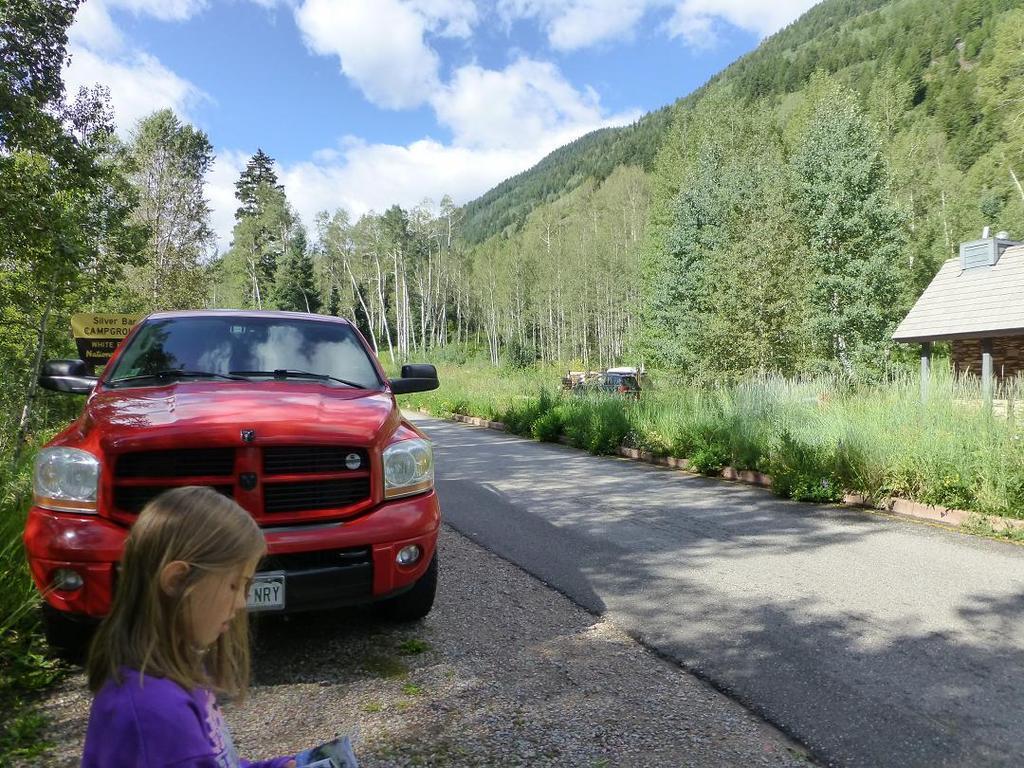

Where we ended up waiting for the tow truck
Wasn't too bad - 90 min wait - at least there were bathroom facilities at the campground right next to us

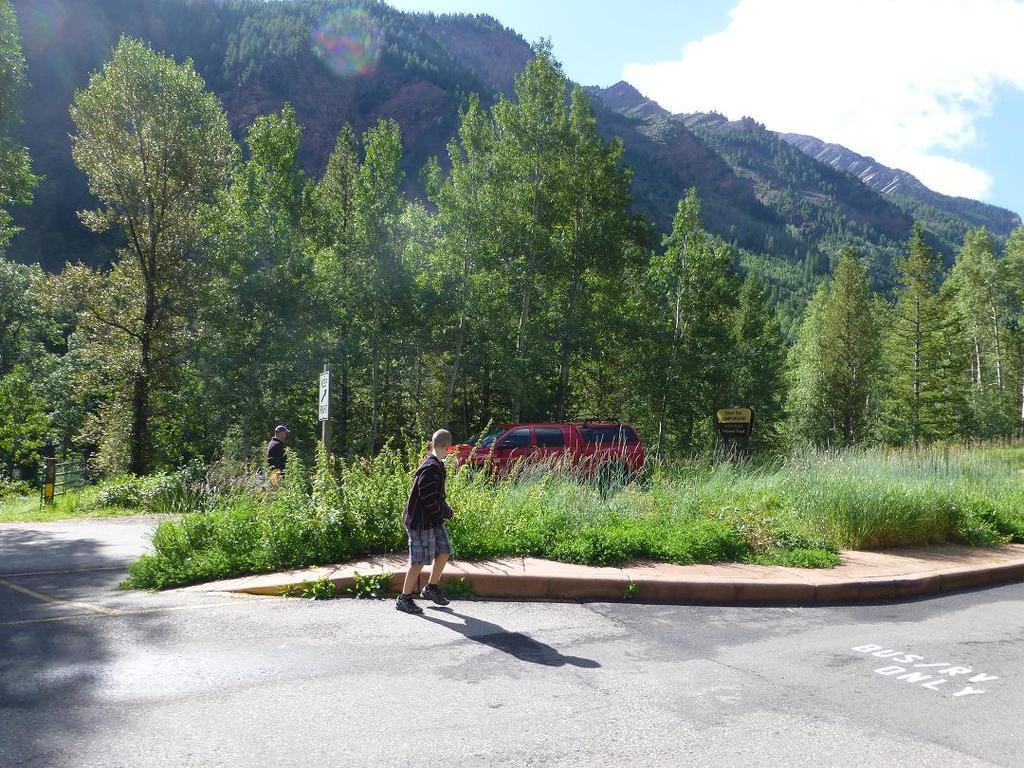

The 1.5 mile hike from PDA to the nearest bus stop - Adventure!
