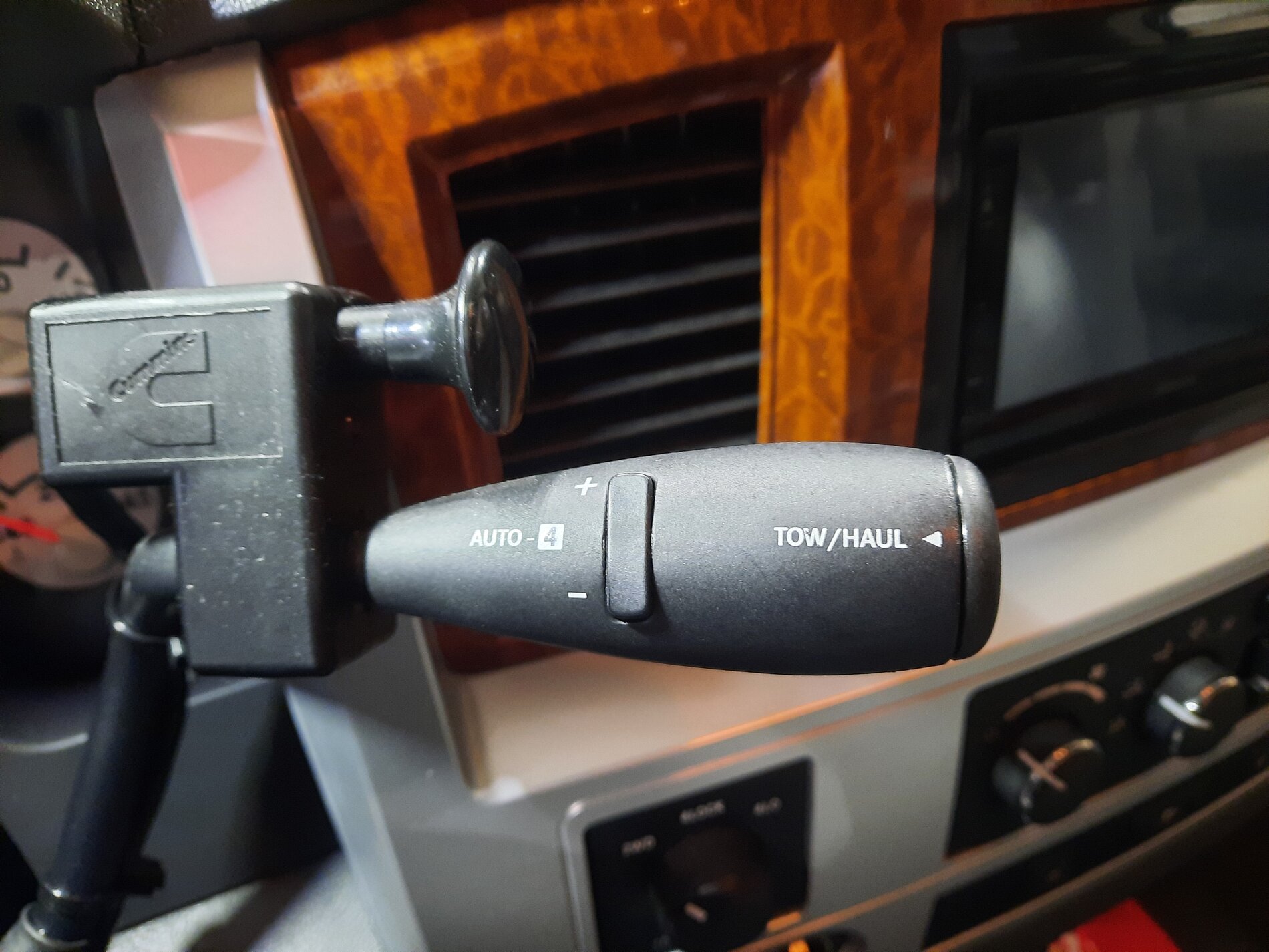

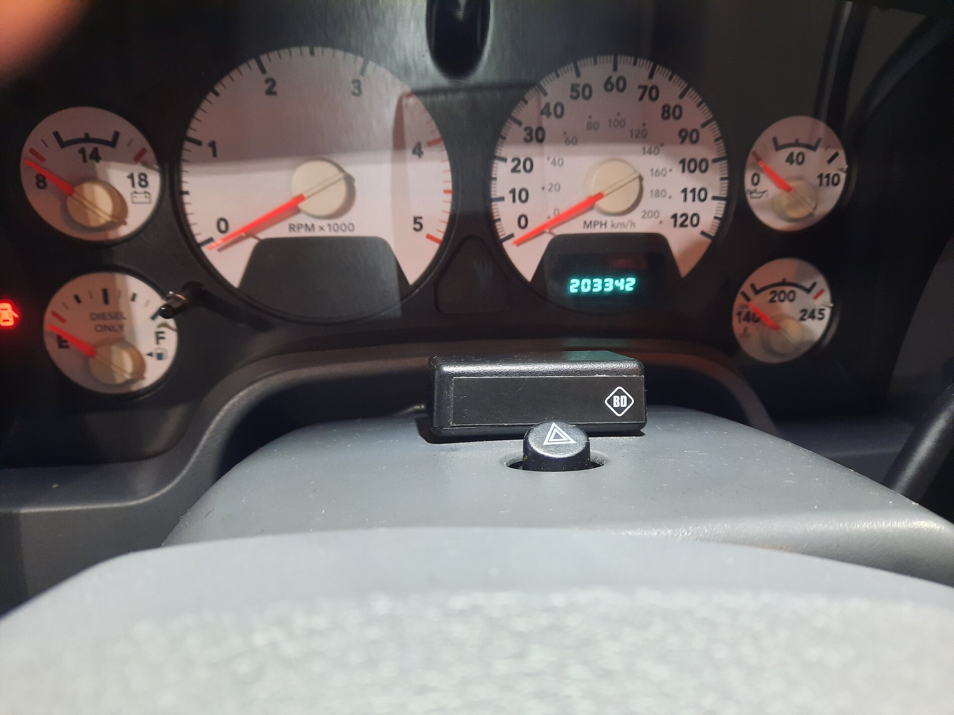

I have only had the transmission for, as I said, just over a year, but it has been performing well and I am happy with my purchase. I know there are a lot of 3rd gens that are getting long in the tooth (I just crossed the 200K threshold recently) and I often see treads on folks fixing, upgrading, or replacing their 48REs and wanted to let the group know about this option. In addition to the transmission and TC that I described above, I also had the BD billet flexplate installed (was discounted as part of the “package”). The cost was around $6850 for the parts and $1600 in labor (labor also covered the installation of a one-piece alum driveshaft that I had installed at the same time). The installed product includes the transmission and TC (of course!), an external filter that is mounted on the frame rail, and the OEM gearshift handle is changed out with a handle that has a +/- button (the T/H button remains - I believe the shift handle is OEM but from a later MY). There is also a display module that is mounted in the cab (I have it mounted on the steering column as shown in the picture). The display is normally blank unless you select the “-“, which causes it to show the current gear, and it displays the highest gear until you hit the “+” enough times to put it back in “normal” mode (I think BD calls it “turning the tapshifter off”). The install procedure uses quite a bit of trans fluid due to the requirement to flush everything, but Travis let me supply my own Amsoil fluid that I had purchased in vast quantities in preparation for the job.

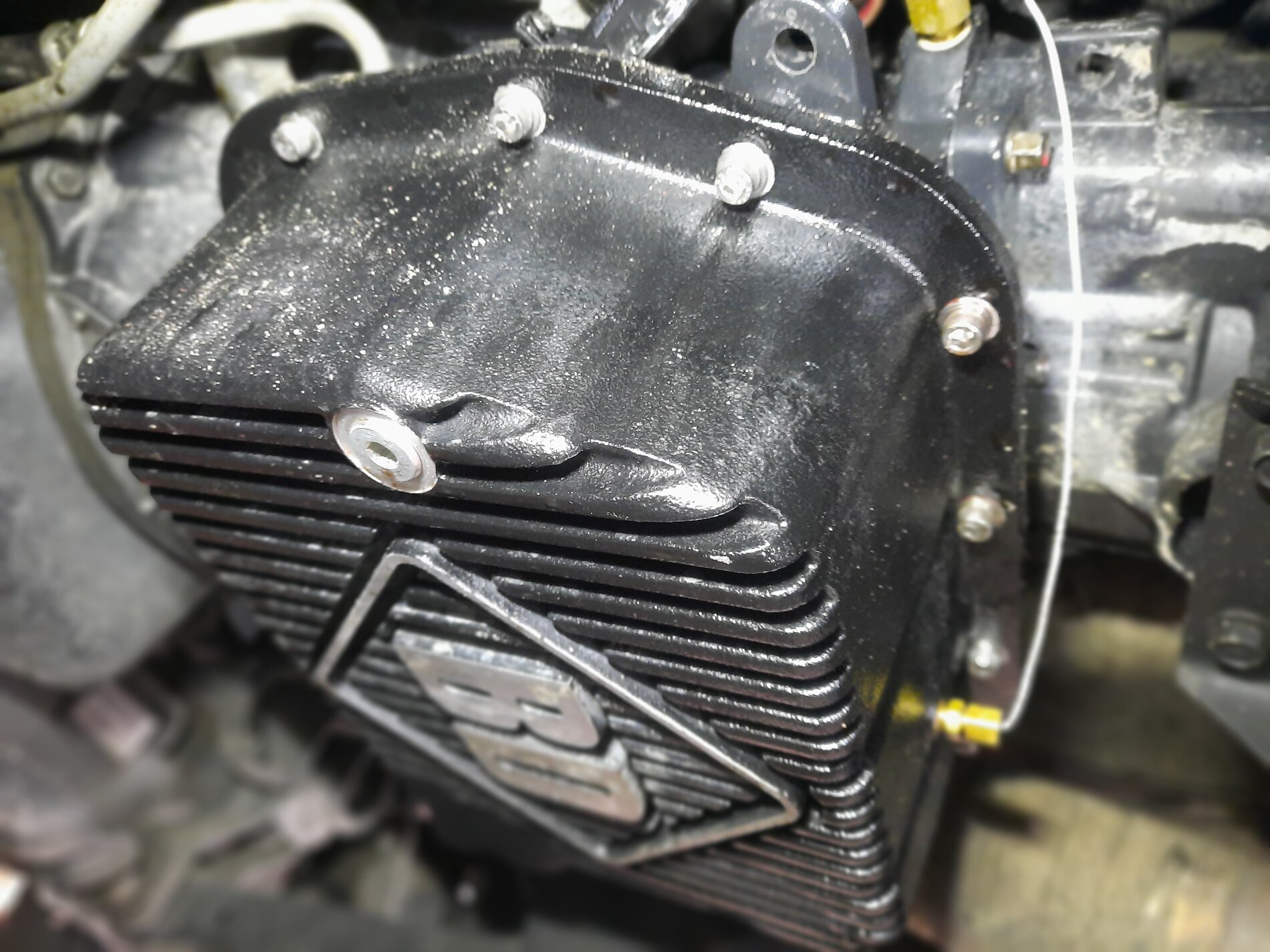

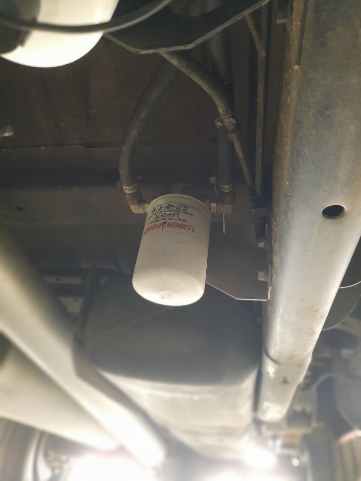

Pics of Transmission/components:
1. Display module that shows current mode and max set gear.
2. External Filter
3. Deep Pan - wire coming out the back is not temp probe, but rather control for the tapshifter solenoids.

5. Pic of the new shifter
