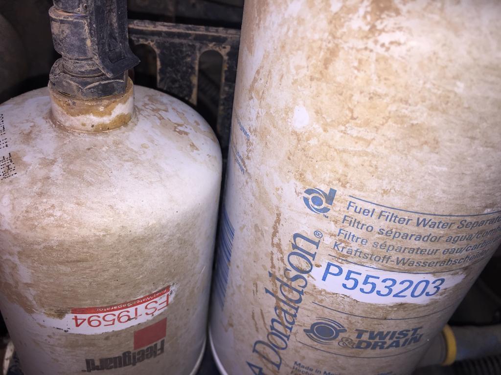

For those that have the old style FASS fuel systems I was able to regain my Water in fuel sensor by buying this one made by BD diesel for their system. I just unscrewed the fuel drain and installed their sensor in the bottom. Now I'm able to completely bypass the stock filter bowl and sensor and leave it for my backup if I have to switch back to my old pump.
