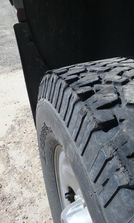

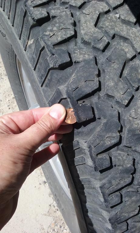

Right rear tire shows wear pattern, like the rubber is being smeared off the tire sideways.
Had 4 wheel alignment done, no problems there.
Rubber edges are very strange. Please see the pics, one has a penny to show scale of "overhang". The other picture, zoom into the top outside edge of the tire, where it is silhouetted by the mud flap, see the 'flap' hanging off the edge of the tread?

IMO, the wear in the second pic cannot come from the tire rubbing the ground. To leave that 'overhang' requires something to rub the tire below/inside it (toward the wheel). Mudflap? Wheel well liner?

No rubbing, wheel liner and mudflap are secure.

The axle has a flange on the outer end (the eight bolts you see in center of hub) and can be pulled out when you remove the eight bolts. Don't thin you are going to find the problem there. If the hub nut came loose the hub, wheel and axle could walk out causing the tire to rub on the fender but you can bet it would not go back in place while driving. Don't know the size of the hub nut but if the seals are not leaking or you can detect play in the bearings I wouldn't remove it. The damage on the tire looks like something came in contact with it while moving, have you hauled anything that extended out over that side of truck or been stuck in mud or sand and spun the rear tires.
