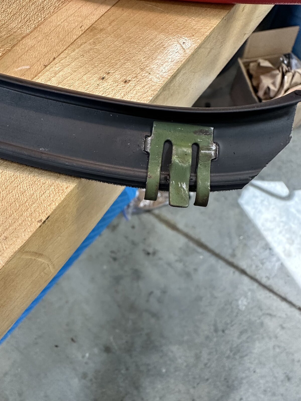

FWIW, vintage British cars use individual clips to hold their sweeps. They are not molded in or attached to the sweep.
These may be purchased along with a special tool to install them. I recently worked with the owner of a restoration shop on a TR6. I saw these clips installed and can vouch for the fact that they do not let go once in place. I've got the tool and clips now and plan to give them a go.
Took the clip from the outside edge of my old sweep and transferred it to the new one. Only way to keep it down. The new ones DO NOT HAVE THE TEETH on the center part to grab the metal.
Same manufacturer apparently makes these for everyone. If there are better ones to be had I'd like to know.
