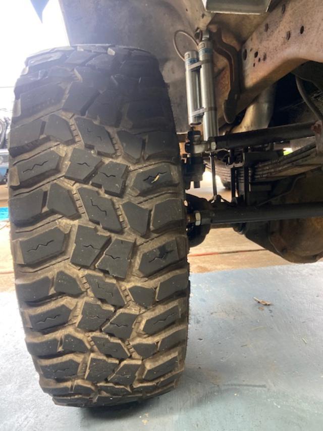

I am not sure what is considered the best or not but so far I am pleased with the Bilsteins. With Fresh bushings and shocks all around this thing feels way better than it has in years past.
Ispy:
ORD zero rate add a leaf
Heim jointed draglink/crossover
Looks like a heim jointed low steer tie rod
4" downpipe
Some lift springs
Some remote reservoir Bilstein's.
Ispy:
4" downpipe
Some lift springs
You are pretty spot on. It is 4” springs with the zero rate to push the front 1.5” forward so it’s around 5” of lift.
I wanted it pushed forward to keep the 37s out of the firewall/ fender yet keep the truck as Low as possible.
