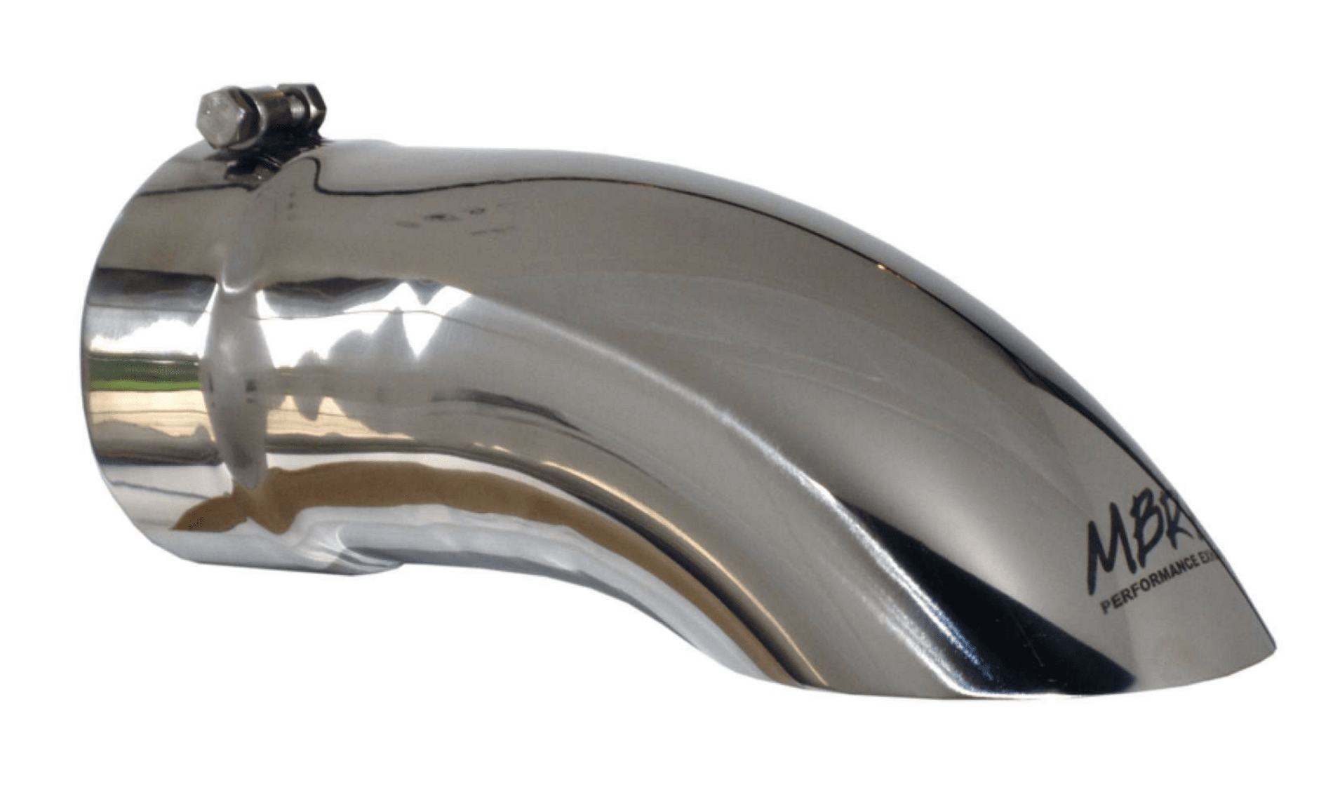

I used an MBRP 4 to 5" polished stainless turn down tip on my 3rd gen and it works and looks great IMO.
No one can see inside it since it's a turn down tip and that also helps keep soot off the rear quarter panels when Im driving under load. ;)

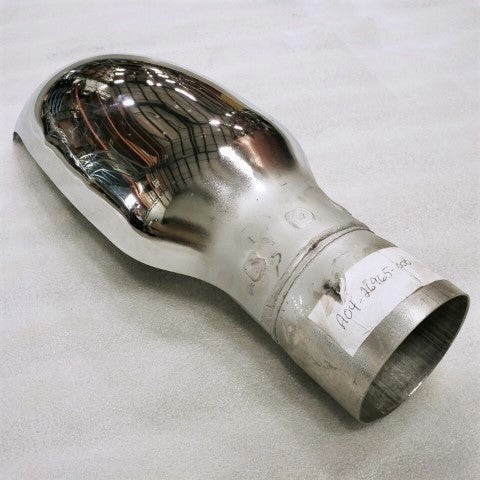

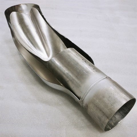

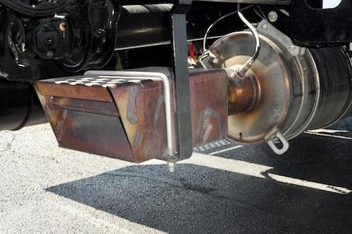

Big trucks of any class are remarkably quiet these days. Credit SCR, but exhaust tip diffusers are a part of it.
Some you might not “believe” were I to post them. Yet have Mack or Volvo or Freightliner part numbers.
(Have some fun while looking).
The turn-down problem is one of location and rotation.
Y’all know how GM orients their diesel diffuser tip. The pipe needs to remain higher after the axle bend (would interfere with spare) and angle slightly towards center, but an end-downwards location with tip rotation not ground-parallel, but slightly towards vehicle center . . utilizes aerodynamics to keep back pressure reduced.
Think on the low, rotating dust cloud develops behind a speeding pickup on a summers dirt road. That “cloud” can be utilized for exhaust scavenging.
— Keep most of a long diffuser hidden from view. Angled slightly over towards center , exiting down, and rotation-clocked.

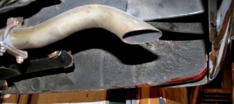

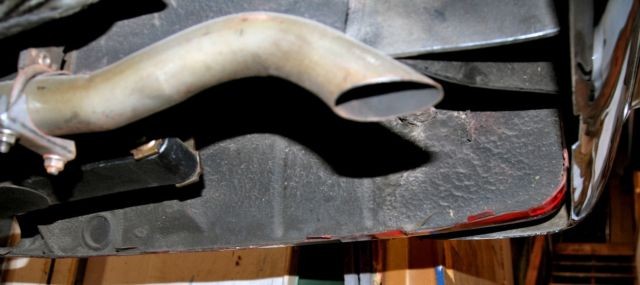

Chrysler Corp engineers did plenty of exhaust science work in the early 1960s. David Vizard will take you through the steps if you want. Any 440-powered Police Pursuit had duals that turned up before bending down to exit, and tips should have been clocked slightly towards each other.
I did the same on my 06. It kept the soot off the Torklift camper tie down. I did cut the factory pipe back some so it didn't stick out much more than the stock pipe.
