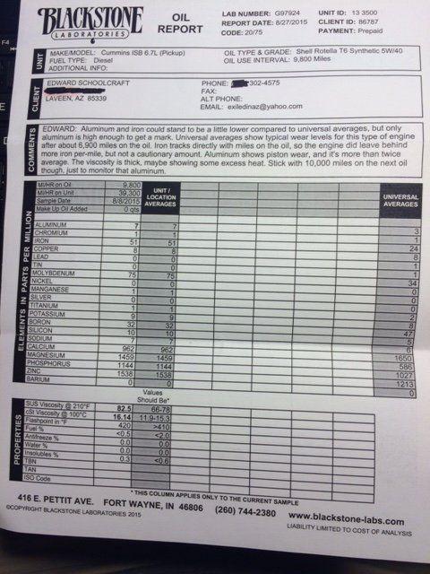

Finally had the oil checked by blackstone. Apparently due to excess heat.(as I have been griping about with this particular truck).. Other metals are high etc.
Dont know why its sideways...Sorry.Any feed back would be good. Going camping this weekend and will report my "excess heat" issue with video this time. Might as well have fun with it..
