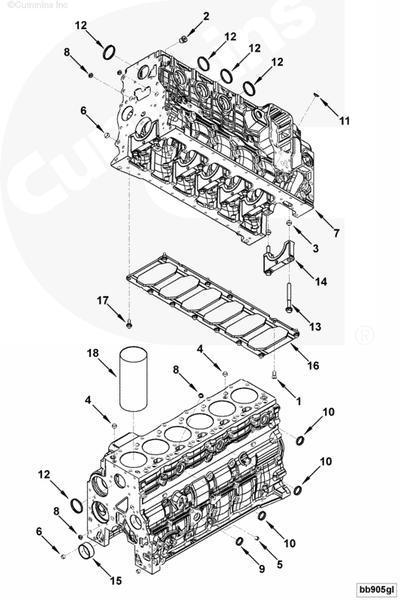

Just for grins I priced the repair sleeves.....Part number is 3904166.
Item #18 in the illustration.

$52.00 each. If the machine work isn't too pricey maybe doing all 6 is not a bad idea. And the Cummins factory has over 8,000 of them in stock so availability is not an issue.... :D
