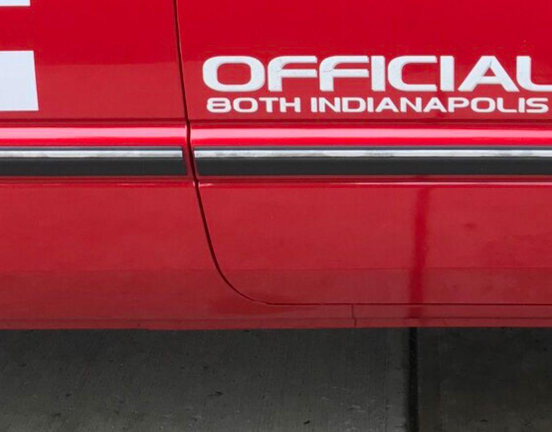

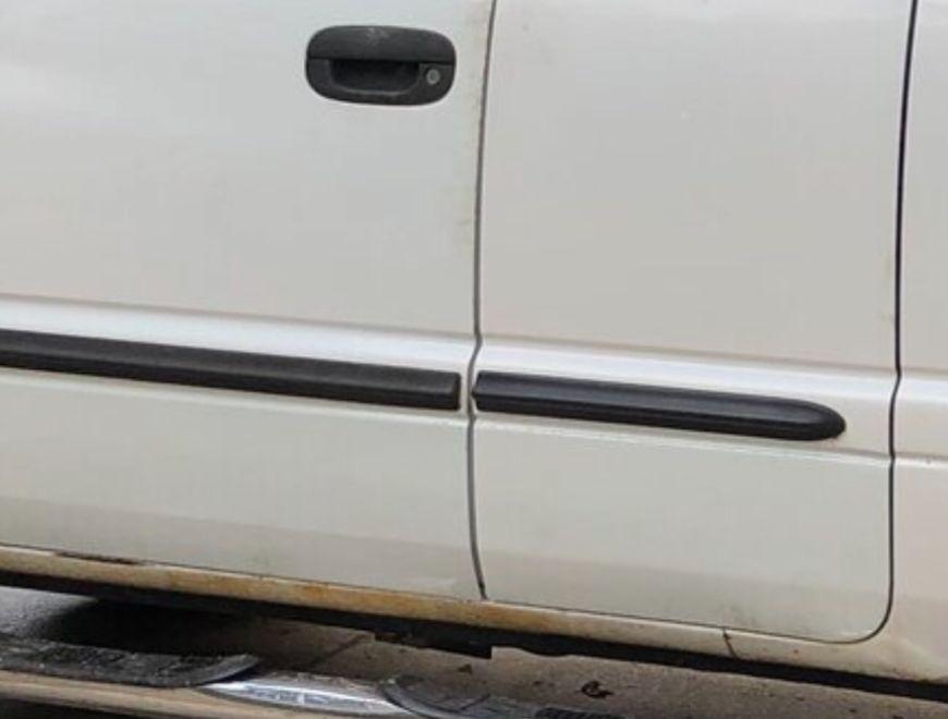

I need to replace a lot of the sheet metal on my 01 quad cab, it has had a very rough life. Questions:
Are the doors off of a 94-98 regular cab or club cab the same door as 98-02 quad cab?
You can make a power door a manual door if you have the regulator and correct door panel?
Fenders and hood on second gens all the same correct?
Just want to double check before buying parts.
No, they’re different. The lower rear corners on the RC and CC are rounded. The QC doors are squared.
