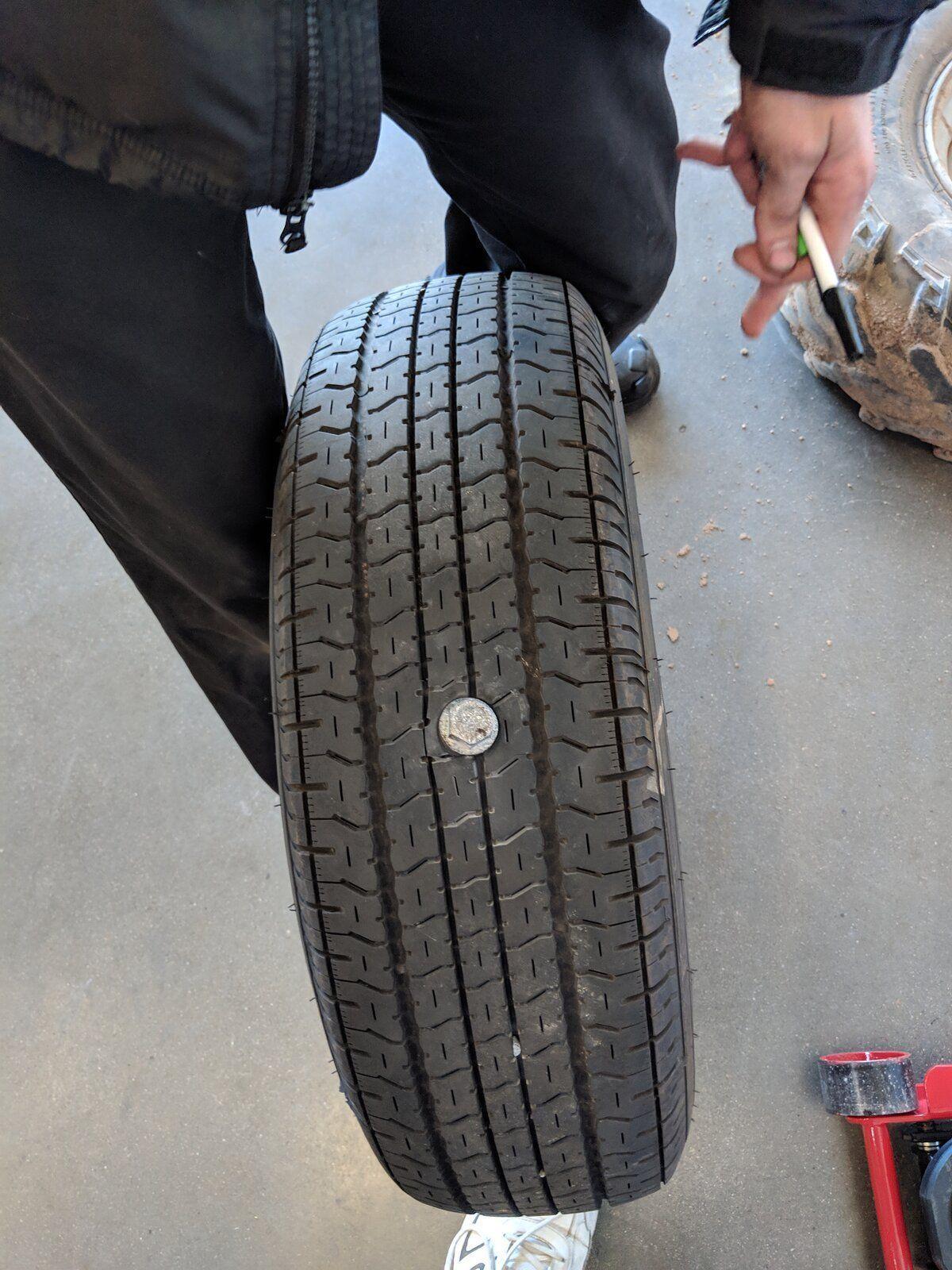

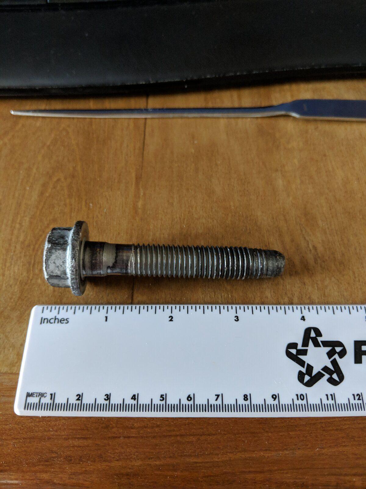

We took the Little Guy Laredo to Tucson for four nights. When we got back to Gold Canyon the left rear tire was going flat. It happen in the last couple miles of the 100 mile trip. This is a case of knowing exactly what caused the failure. The bolt showed little signs of have been run of the road very far. Attached is a picture of the bolt in the tire and the bolt that I kept as Discount tire was installing a new Endurance ST225/75R15E.

Does this bolt look like something that came from our 2015 4x4 3500?
Snoking
It does look like an OE style bolt but whether it's from your truck is almost impossible to tell. That's an awfully large diameter bolt to punch a hole in the tire. I would think you would have just rolled over it...bad luck I guess.
I agree looks like a suspension bolt to me as well but from your vehicle who knows just have to take a look around under there and see if any are missing. I had a 3x1/2 inch lag bolt go through my front tire last year. she went flat pretty darn quick.

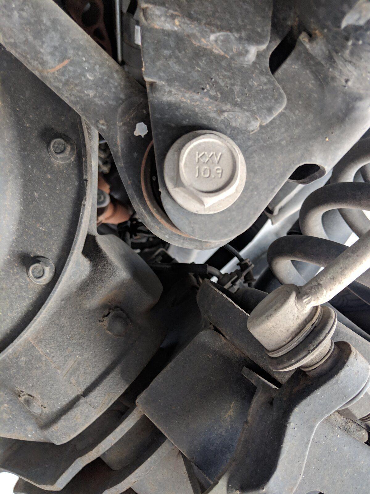

Well the bolts on the truck have the same KXV 10.9 on the head. I can not find a missing one yet. Put it in a door pocket and when I go for the drag link recall I will have them look for it. Attached is a picture of a larger similar bolt. SnoKing
If you were missing a bolt that size you would know it pretty quick! It does look like a OEM bolt but fun fact of the day 100% of all cars on the road come with OEM bolts so looks like it came off a vehicle, just not yours.
Could be a brake caliper bolt. My sons car lost one this winter. When we went to Napa to get a new one, they told us they’ve sold over 30 of them this winter.

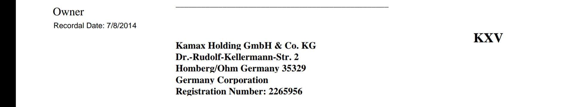

KXV is mfg stamp

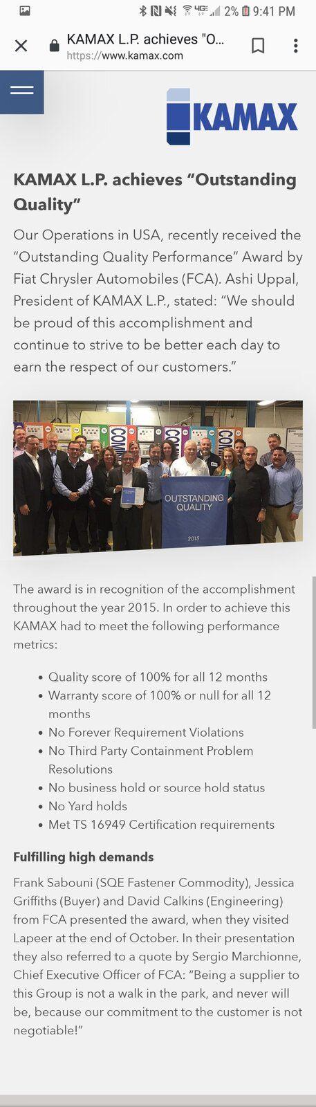

They are a pretty high end FCA supplier or so from this snippet on their web site.

Not really. Skid plates if optioned that way. This bolt show signs of having been on the highway.
