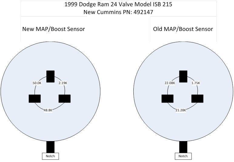

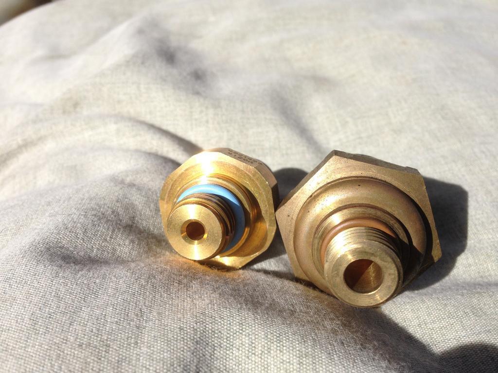

MAP/Boost Sensor Solved
Replaced the original sensor with new Cummins 492147 (Geno's Garage) and problem fixed. Look at the ohm readings of new and old and the opening size.
Socket size:
Old sensor 1 1/4
New sensor 1 1/16
