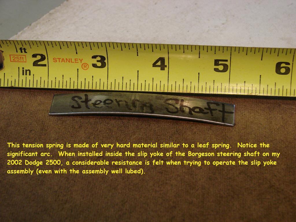

After returning from our trip I decided to remove the Borgeson steering shaft to get access to all of the lock screws - there are several on each end of the shafts. While inspecting the shaft on the bench I noticed that it required considerable effort to operate the slip yoke assembly. I looked it over and found that I could remove a set screw and separate both shafts. I did so and when I slid the shafts apart, a piece of steel fell out. The piece of steel appears to operate as a tension spring. It is about 3 inches long, about 1/2 inches wide, and about 1/8 inches thick. It also has a significant arc to it. I re-lubed the working parts and reassembled the shaft. The slip yoke was still hard to move. I disassembled the slip yoke and put the tension spring in a press and reduced the arc by half. I reassembled everything and rechecked slip yoke movement. Still hard to move.
At this point I just stopped with the project. I am thinking that it is very important that this slip yoke moves freely - not just in case of a vehicle collision (because it would still move), but just in normal operation there would always be minor changes in distance between the frame-mounted steering box and the insulated cab mounted steering wheel. So I reassembled everything again, but without the tension spring. The slip yoke moved easily and smoothly. There was no appreciable play when opposing torque was applied to each shaft end.

The photo below shows the tension spring removed. Each time I disassembled the slip yoke, I noticed that a small area on the top surface of the spring was completely wiped dry of lubricant even though I lubricated it during each assembly.
