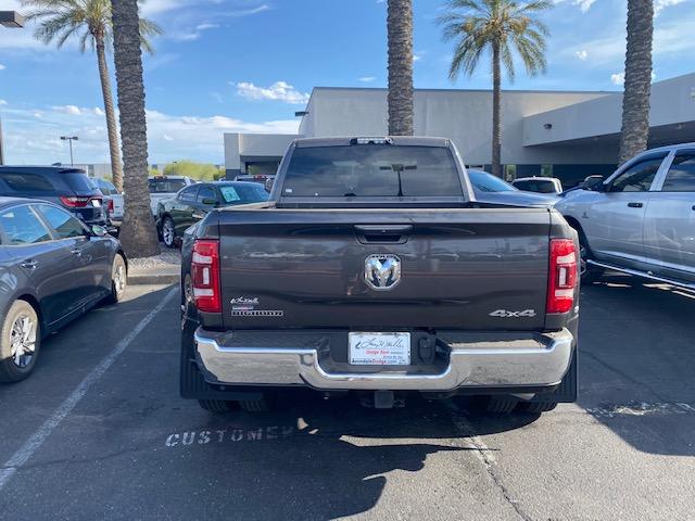

Bought a new RAM 2020 Mega dually 4x4 AISIN.

Was not intending to buy one, but some circumstances came up...... Anyhow, found out (have not been on the board for a while) that AAM has a 12" rear axle and no finned cover etc. How are these axles working out so far?
