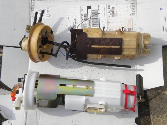

The fuel guage can be bouncing all over the place because of the in tank module. I bought the sending unit thinking that was the issue, no soap! When I got it out I found the entire thing had rotted in half inside the tank! Well, that would certainly explain why the guage was all over the map!
What do you think? Did it need replacing? BTW, the lines on top were rotted and sucking air as well, made for very hard starting.

My gauge was bouncing for years. When I finally had to drop the tank (to replace a rotted brake line behind it), I found the supply and return connections on the module completely rotted away. The level sender was another problem. I found a '97 module locally for a fair price. And found it wasn't the same as the '98. But I swapped parts around and got it working.
Among the parts swapped was the resistor sweep 'plate'. Cleaning it didn't help much. I finally put a 'u bend' in the contactor arm to shorten it by 2-3mm so it sweeps a different part of the plate. Finally, after 8-9 years, I can fill the tank without fuel spewing out the top of the module, and the fuel gauge runs smoothly from full to empty; it finally again dings *once* when it reaches ⅛ tank.
Should I mention I had to drop the tank 4 times before I finally made it work right? The '98 uses a friction-fit between the pickup tube and the filter inside the basket; the '97 uses a gasket; I didn't reassemble it right and that gasket was holding the valve at the bottom of the basket shut; soon as the fuel dropped below the basket and the basket emptied, I ran out of fuel--with more than ¼ tank left. Four times I dropped the tank before I figgered out what I done did wrong. I got real good at it!
