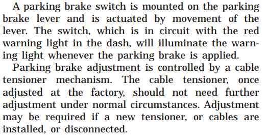

Parking brake light and ABS light on intermittently. Anyone else have the same issue? Corrected it?

Check for codes and check your abs and wheel speed sensors. For the parking brake there is a contact point for the light circuit on the brake leaver itself. It's a very simple design, it makes contact light is on, no contact light is off. Check and verify under the dash.
