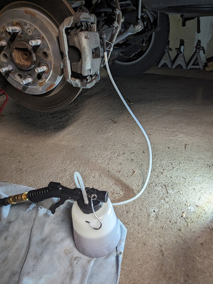

So I had some spare time today and swapped the fluid. I also took each caliper off, cleaned them up and refreshed the lube on the slide pins. I am totally glad I did. I actually notice a slight performance increase in my brakes!
I used my vacuum bleeder and as usual, it makes quick work of this type of stuff.

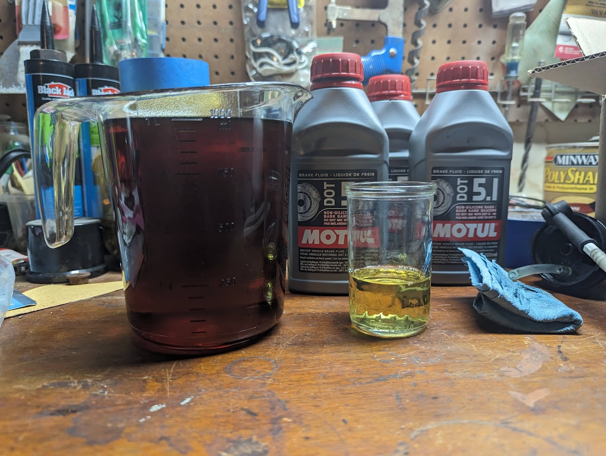

I did decide to go with the Motul DOT 5.1 fluid just to see what if it really is good. Probably overkill, but whatever, it was a few bucks more than local synthetic DOT 3. I used up 3 bottles, had a little left over to show what new fluid looks like.
From now on, every 2 years max on brake fluid!
Here's what came out at a little over 3 years and 52,000 miles:
