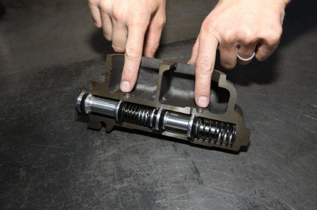

It is possible that the front brake piston or piston seal in the master brake cylinder bottomed out during the brake application. If the piston or seal was damaged, the piston may not be returning all the way. If this is happening the seal would not return past the compensating port, thus trapping brake fluid in the front brake circuit.
Thermal expansion alone would cause a small application of the brakes.
The fingers in the attached photo are pointing to the compensating ports.

I agree with that. With the help of another person you may be able to determine if there is action at the compensating port. Remove the filler cap from the master cylinder. Watch for any movement of the brake fluid while your helper lightly taps the brake pedal (engine off). With very little movement of the piston, the primary seal will pass by the compensating port, thus stirring the fluid in the reservoir. It may be difficult to observe with the small viewing area through the filling hole.
If you can detect any motion, then the master cylinder is probably okay.
