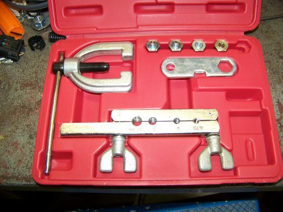

I just went through this on my Wife's '98 Durango. It has bubble flares too. They DO make short adapter lines from whatever size metric nut bubble to 3/16 inv. flare, to use if you're in a jam. The line was 3/16 strangely enough. I used this tool. It's the bees knees.

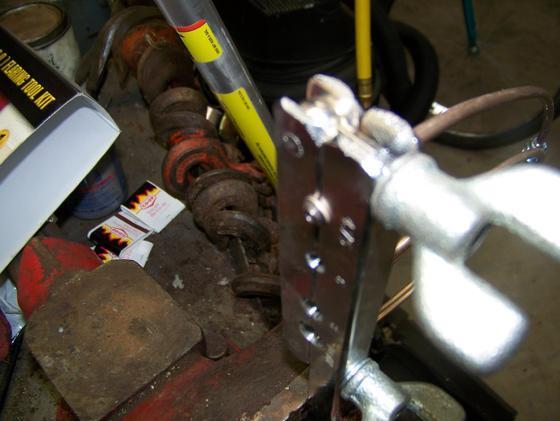

Here is what I bought, brand is ATD.
Good enough for the DIY guy.
Mike.

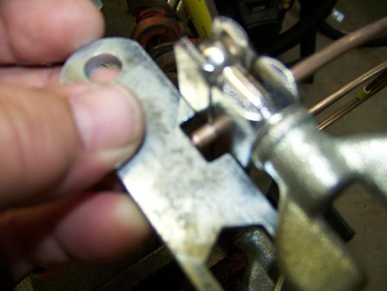

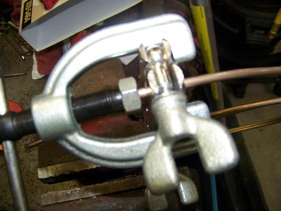

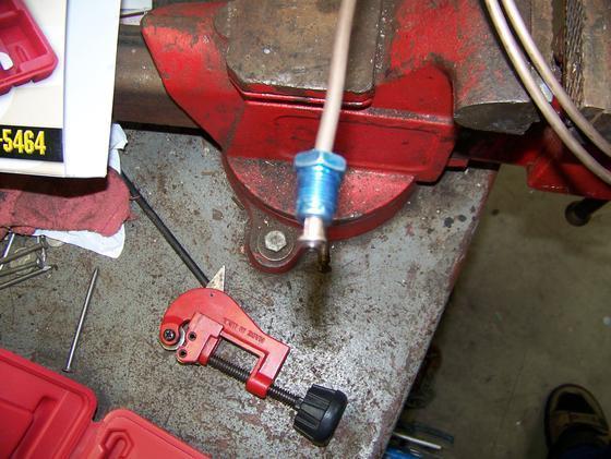

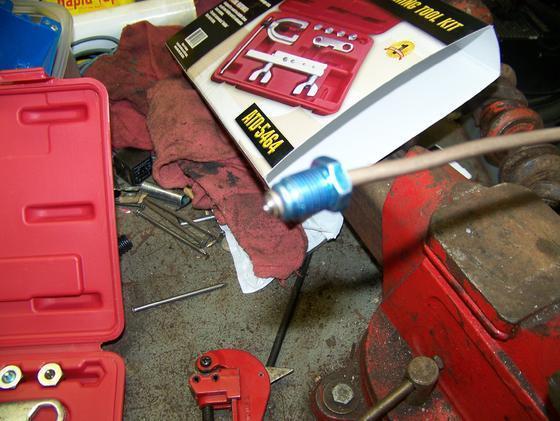

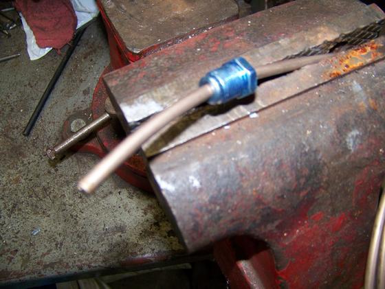

Quick how to...
Copper/Nickle Alloy Line
Slide Tubing Out To Depth Of Notch
Attach Adapter To Swedge Tool
