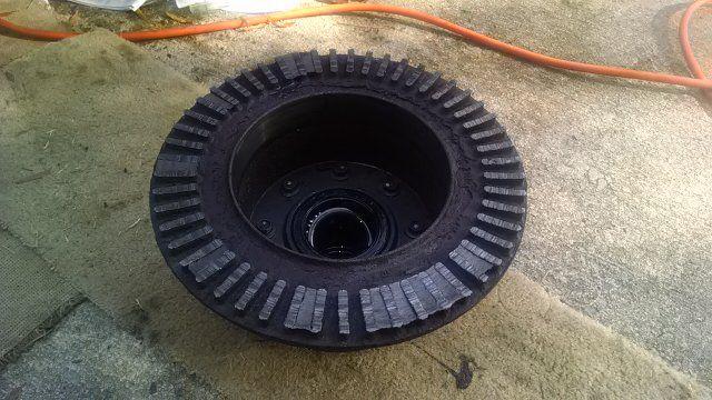

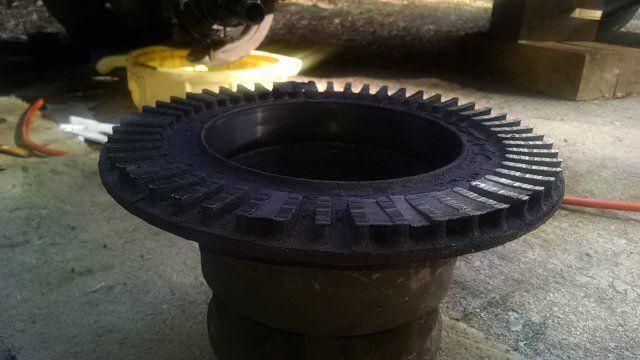

My right rear brake caliper has been sticking for a while and when my son traveled to mountains with trailer to pickup my 1500 4x4 he said brake pedal was real soft. When I got home and climbed under truck here is what I found. Today I replaced rotor, caliper, pads and bearings and races today.
Wow! I have never seen one split like that. I stripped the drum from the hub on some Studebaker front drums about 60 years ago. bg
I don't think that one pad could have lasted long enough to wear thru 1/4" of steel on the rotor. I think the rotor got hot enough for it to break apart. Either way we were luck to make it home.
I don't have a picture of it, but the left rear rotor looked just like that on our 04.5 when the caliper stuck a few years ago. The caliper wasn't stuck for long either.
In this case is is expensive to let a brake problem like a sticking caliper go for any distances.

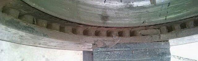

Duracrap failures below. Note where the backing "broke off" at the pad material retaining holes rather than wearing down to them.

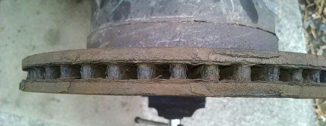

As mentioned earlier, Fords were known for sticking calipers and the result looked identical to your failed rotor. The evidence is the remaining metal "skins" between the cooling fins inside the rotor that remain.
